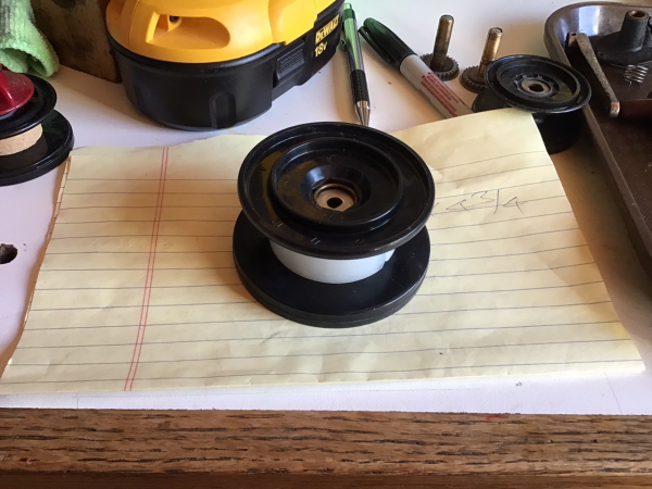

Here is a reel that D.A.M. designed to be a cross between the tough old 330 and the giant 550.
A reel was needed with a large line capacity but not as heavy or bulky as the 550 or 270 Super.
This reel incorporates the frame and gearing size of the 330 -- with a line capacity rotor & spool approaching the larger reels.
This is an ideal reel for larger Salmon, Steelhead, Mackinaw, Lake Trout, Stripers, Muskie, Cats, and Carp.
There are a few features on this model that are unique to this reel.
This particular one I built from new parts out of the old bins this afternoon, for a member.
It features an upgraded, stronger, and longer crank, oversize knob, and is set up for a right-hand crank.
Just have to adhesive the jumping fish emblem on the left side -- then bag up and send them out tomorrow morning.
