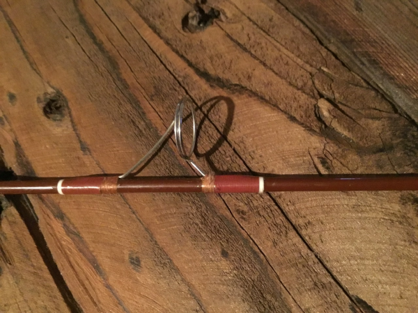

I've had this rod for 43 yrs and I still use it to this day. I had an extremely unusual day fishing, I ended up fighting and landing 2 steelhead in a side pond fed by the Clackamus River. I broke the 2nd line guide but did a temp fix but can not find a replacement guide. My only contact I have wants to replace all the guides with modern guides but I'm not into that.
Does anyone have contacts or info that I can use to get this great little rod back to it's former glory?

Do you have a picture of the guide type in question?

ClintB
I'd like to find somebody that has a guide and can do the replacement.

That guide looks like an old Aetna "Foulproof"; they aren't made anymore as far as I know, but you occasionally see them available as NOS.  There is another outfit whose name escapes me that is currently offering a similar-type guide; I will dig up the name if someone checks the online components sellers & can't locate what I'm talking about.
I just might have one of those if you tell me the diameter of he ring part of the guide.  No promises.

I have some of those guides, post the size and I'll check
ClintB
The outside diameter of the ring is 3/4". It stands 1" tall measured from the rod surface. The length is 2 1/4" from foot tip to foot tip as best I can tell. I've been trying to hunt one done locally but no luck.

Clint, check out Kevin's videos on Youtube under the name The Fishing Hobby.  He explains how to wrap a guide on.  He does a good job explaining how to do it.  Easy peezy.  Dominick

FWIW, Fenwick used Gudebrod NCP #541 medium brown size A for those wraps. You may be able to remove the brown thread & save the trim wraps so you don't have to buy two colors and screw around with them. Gudebrod 541 is easy to find.

I know it because Cabela's, originated right here in my home state, used to sell Fenwick blanks & kits and when you purchased a kit with guides, handle, thread, glue, etc. the thread in the kit was Gudebrod NCP #541 medium brown size A, and, #541 medium brown, for many years, has had an AKA of "Fenwick Brown". Plus, they were owned by Berkley/Pure Fishing right next door in Spirit Lake, IA at one point and a lot of folks have researched re-wrapping Fenwick brown blanks and shared their findings.  :)
