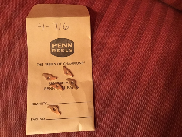

just curious about the the penn 4-716 dogs..some have holes ..others don't..on some of the reels ive dug into ..whats the purpose of the hole..both seem to work in either the 714..716...
joe k
Either dog will work the same, Joe --
The later ones had a hole for the leg to go into -- which some say keeps the dog spring from jumping out.
But the traditional arrangement works just as good -- where the dog spring leg rides against the dog to apply pressure.
Both work as they should.
