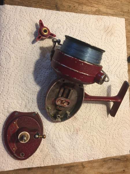

This was one of the first Quick reels that I picked up a few months ago. I believe this is a 1956 -1958 model?  Serial Number is:  137191 with Made In Germany on the foot.  Learning from Fred, this is the predecessor to the 330.  Wanted to show my tear down on this reel and then after its cleaned up, my reassembly.  Fred, if you're watching...I think I am missing one or two parts on this one.  If you look in the pictures below you can see the little black "dot" that is missing from the bail arm?

Remove the three screws on the handle side and don't forget the one at the bottom.  Yeap, has that good 'ol dark brown "beeswax" from the factory.  Apparently this stuff has preserved the parts in these reels for decades...wonder if the German's actually "forethought" the grease becoming a preservative instead of a lubricant at some point.
Beachmaster
Take the plate off on the non-drive side, three more screws and then another smaller screw at the bottom.  These two screws at the bottom are not quite as long as the others.

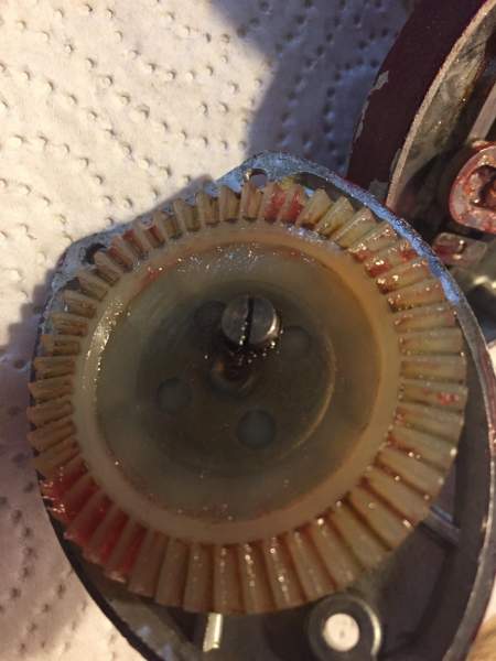

Go ahead and remove the very small screw that attaches the oscillating arm to the drive shaft.  On other models its just a pin that slides in.  But on this one it threads in; an eyeglasses flat head is perfect for this task.
Beachmaster
#7
Now the Main Gear and the oscillating arm will come out.  You can also slide out the Drive Shaft. The next task is to remove the oscillating arm from the Main Gear.  There is a small C clip and a tiny brass washer behind the C clip.  After removing the arm, there is another tiny brass washer behind it.
