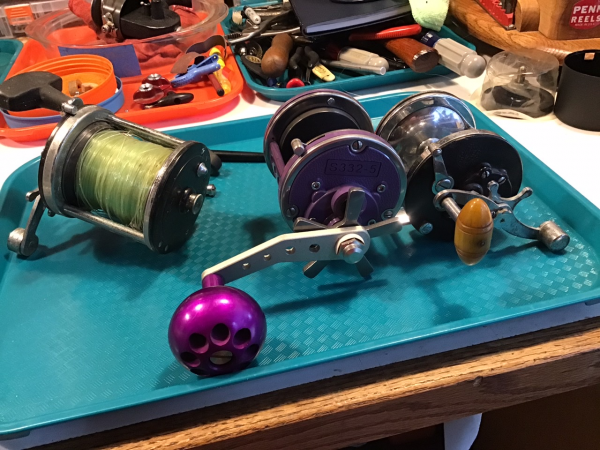

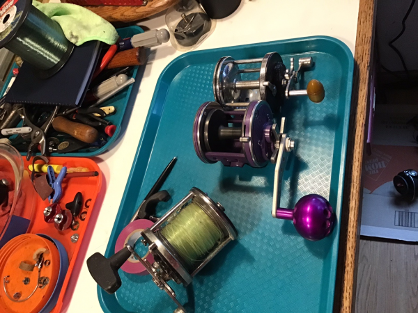

The reel on the left is just an old Jiggy 500 I pulled out of the bins -- it is wider by a bit.
The purple Newell 332 in the middle has the same spool width as the old Silver Beach on the right.

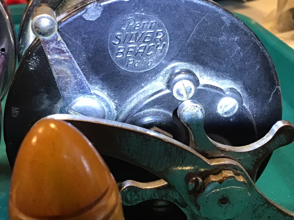

Some of the early, and now discontinued Silver Beach's were labeled "Silver Beach".  A little later, they were labeled as "99".  Same reels however.
The 1:4 gear ratio of the Jigmasters -- coupled with the slightly narrower spool -- makes a formidable combo.
