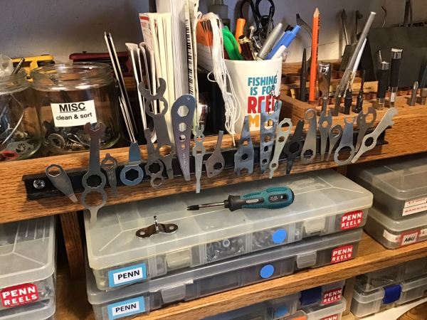

Good question, beats me. Some of the Shimano screws are the worst.  In a pinch I use a coin and my dykes
I believe hollow ground Brownell's gunsmithing drivers may be what you seek- Fred will say for sure. I just use a big bit as-is, but you could grind your own with a file to the profile you need and just keep it in reel tools bag. My 0.02.
Brownell's, Wheeler, Chapman, and Grace all have good hollow-ground screwdrivers.
These are gunsmithing screwdrivers.
Some folks are OK using any old cheap screwdrivers that they find -- that doesn't work for me.
And you don't need to break the bank when acquiring tools.

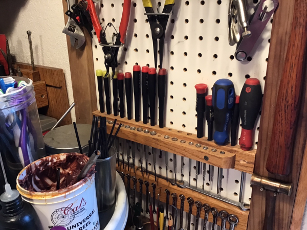

Personally, I made up a complete set of reel tools and spare parts -- it goes on every trip.
It is in a soft case and weighs about 8 pounds.
The key is having a hollow ground screwdriver blade of the closest to the exact slot size possible.

Screwdrivers and tools are not really that expensive -- I just get what is needed.

SoCalAngler
I bought a cheapo multi-bit driver that I keep in my tackle box. This driver holds 7 bits, 3 different size blades, 2 sizes phillips heads. 1 #14 spanner bit and one large blade notched for the Avet seat bolts.
It works fine for all my reel clamps and I could even do reel most repair/service with it on longer trips if I wanted or needed to.
