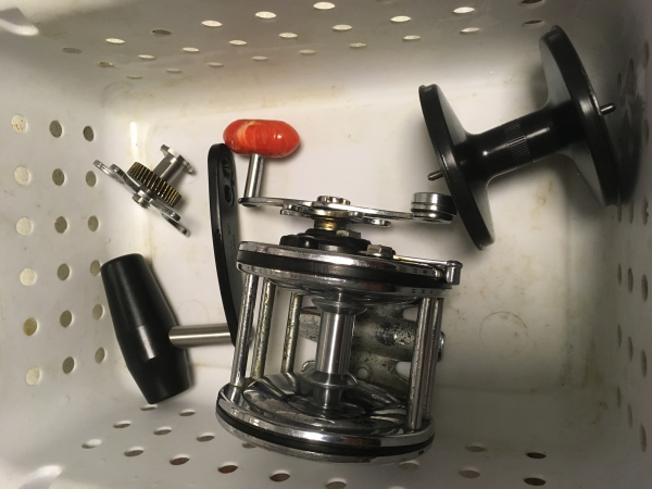

Later I had another thought.  Gearing similar to the Grouper Special is found in the Senator 2/0 111.   It has the 66 bridge, but a smaller, narrower spool as is used in the Long Beach 60.  It occurred to be that I could build a 2/0 beast with modifications similar to the Grouper Special.  It would hold less line, but still plenty of braid for East Coast wreck fishing, and be narrower. With this inspiration, and using knowledge learned from the masters on this site, I decided to build what I would like to call the "Grouper Junior."
Here are the upgrade ingredients that I have to work with:
  • Aluminum 85 spool to replace the chrome one
  • Tiburon T-bar power handle
  • Stainless steel gear sleeve
  • 5-149 main gear and 13-113H pinion: Sal's contribution

I took everything apart, and put the stainless sleeve on.  I believe some guys put a delrin washer under the sleeve, but it doesn't seem possible for this build.
I had another 66 bridge and main gear that I scavenged parts from. This one had a black delrin (I think) washer under the main, which I reused.  The main gear had a 5-stack of carbontex, definitely reusable.
Now the dilemma...  if I use the 5-149 main gear, it will only hold a 3-stack using the washer I have.  I have a stainless 5-66 gear from the salvaged bridge with a 5-stack.   Do I use the 66 or the 149 gear?   If the 149, I'll want to get one of Bryan's 5-stack kits for it, if this reel is going to be the brute I intend.  Plus, if this is really going to be a franken-reel, then it should have the 149.
The other thing that is missing is a stainless dog.   Ideally I'd like to double-dog, but will probably put that off.  Part # for the dog is 15-99.   I wonder if Lee has those.

I decided to put the gears, jack, bridge etc. in before grinding the plate, as a dry run.  I'm going to reveal my lack of experience and say that it took several tries to figure out that the pinion has to go on the bearing before the jack screws, yoke and jack are put in.   Got lots of practice with the yoke/jack orientation.  Left the dog out of the dry run.  Put the spacer sleeve, star and a handle on.
When it was together, it looked good.  I could operate the eccentric okay, but even tightening the drag down, I could not crank it.  It had seemed before assembly like the 149 main gear should be able to move inside the plate, but no.   I should mention that on top of the last drag washer, I added a hard fiber washer and four belville washers. It seemed like those would work well for taking up the space left by the shorter main gear (compared to the 5-66).
Next step is grinding out the plate.  I recall there are three concentric gradations to the opening.  Am wondering if I only need to grind the largest part of the gear opening, or more?  How will I know if I've taken away enough material short of doing another dry run?
This is more challenging than I anticipated, but I've been too much an armchair reel mechanic and am happy to be getting into it.
