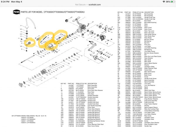

I should probably check into the rotor brake and spring after looking at that schematic.  It's hard to tell but I'm guessing the rotor trip lever (28) interacts with the rotor brake (28D).  If so, then I'm betting it didn't get installed correctly when I reassembled it.

So I dug a little deeper and pulled the rotor off to take a look at the rotor brake components.  It looked normal and functioned properly so I don't think it was inhibiting the bail from closing properly.
I also removed all the bail spring components, cleaned them up and hit them with some fine sandpaper, hoping to remove any burrs that may be causing unnecessary friction.  Re-assembled it dry and it was still sticking.  I lubed it all with Penn grease and it is still doing the same thing.
Here are some pictures.  I may try ordering new bail spring components to see if that fixed the issue.
