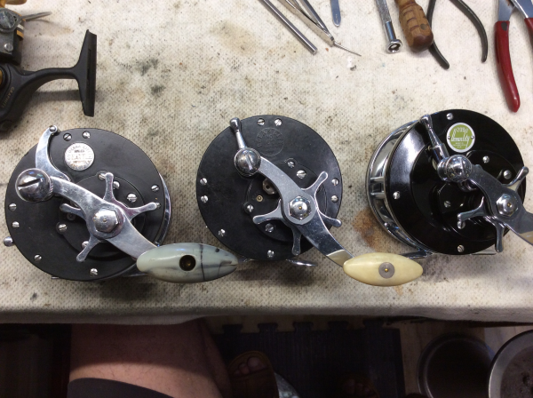

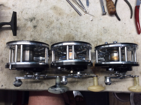

That reel is in very nice condition! For all that were not aware of these little beauties, Ocean City also made some "sisters" to the 209. Below you will find the 109 and the Seattle as well as my 209. These reels are quite hard to find but a "reel" joy to have in your collection. I do agree that they were Ocean City's answer to Penns 49 series or maybe vise-versa? Interesting question. Now I will have to delve into the books!
RC4600
Nice set, I found these ads when I was researching my #209 so I'll pass along. Guess they were all called Seattle's. Hard to believe they sold for the reels for the 'princely' sum of $11.00. hehe I was very impressed with the quality of construction, I've had a few other OC's nowhere this nice. Wonder what they are worth today? I seem to remember seeing one at around $135 a few years ago. RC

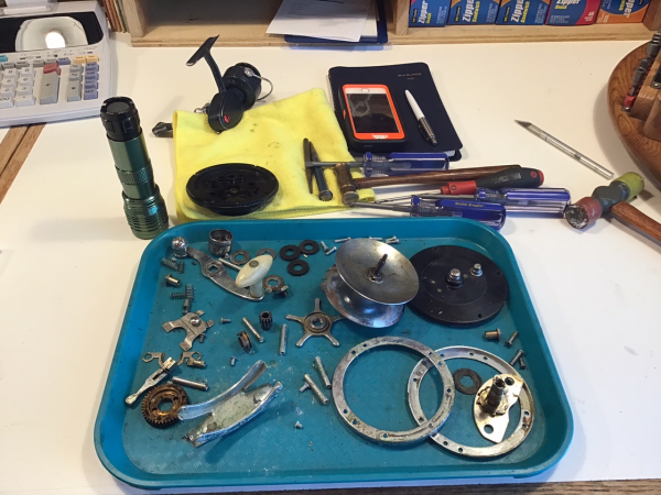

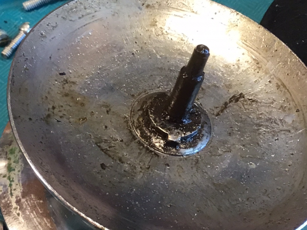

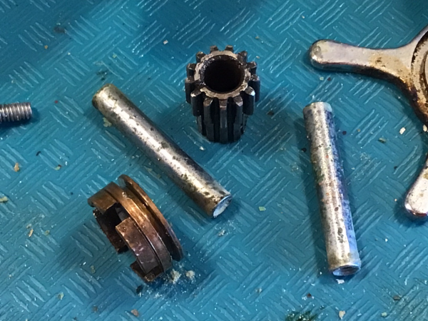

The OC 209 was waiting for me and I was anxious to take it apart.  It is in good condition but I ran into a problem with getting the spool off.  there is no rust but I think the spool is stuck due to corrosion in the pinion gear.  It just won't come out.  Fred to the rescue.  He said to send it to him and he will see what the problem is.  Then he is going to hand deliver it to Wayne after working on it.  As far as good guys go Fred is one of the best.  Here's to you Fred (beer in hand.)  Thank you.  Dominick

Got it in the mail this afternoon, Dominick --
Got it apart -- like you and I figured -- the pinion was corroded onto the spool shaft.
A fair amount of Green Verdigris corrosion inside the narrow frame assembly, some rust in other places -- but not bad -- just about what is expected -- no big deal.
I'll soak it in mineral spirits for a couple of days -- then hit it with the Ultrasonic Cleaner to finish it up -- burnish all of the parts -- replace the drags -- synthetic Grease and oil -- grease the innards and the screws, test, confirm all functions, retest and fine tune -- bag it and give it to Wayne in 9 days -- along with some other OC's for you.
