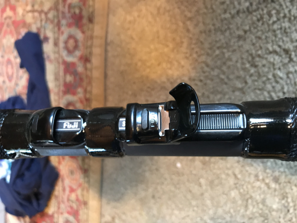

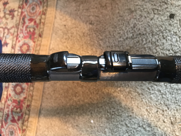

I tried one and wrapped it on with light tarred seine cord and after a couple fish it worked loose. I've done another one this time with thread and epoxy but haven't used it yet but will soon. I'll report back. One thing is it doesn't screw onto the reel, the back hood slides up and a latch folds down the lock the hood in place so it's not infinitly adjustable to the reel foot. The reel I was using was in between clicks on the latch so it was a little loose.

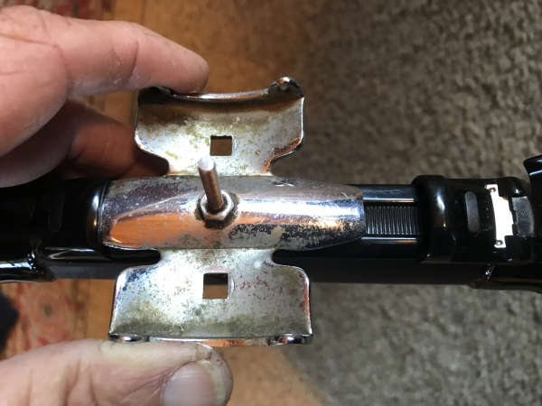

Here's a few pictures.  That latch clicks down on the ridges on the seat to lock the reel down. I had a Calcutta on it and the foot was kind of in between length on 2 ridges so it wasn't snug  I'll be using a Trinidad his time that fits perfectly

 Some tape  these plates in place when used for lighter duty. to use one for a Jiggy would take mounting the plate on blank by wrapping the feet on both ends of plate with thread & finish with epoxy. Also I would not use this plate with a Jigmaster without reel clamp..... Then one has to ask why not a deckhand style build in the first place... Jeff
Good point, I'll be using a clamp with it. The up side is it's a fat blank and the clamp studs on a narrow reel dig into the cord handle to get around it or just won't fit at all. Just another gizmo to fool with, no trick taking it off if I don't like it

Ok, but can the plate seat be mounted onto a standard working old-school all-steel reel seat just like you would a reel? The point is to use the padded clamps of the plate type seat to prevent damage to the reel aluminum foot.

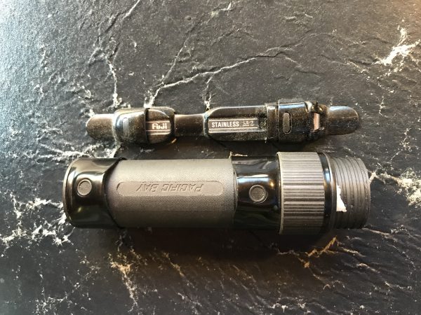

No they are too long. Here's one next to a #32 reel seat, the largest reel seat I know of.

Quote from: Swami805 on July 27, 2020, 01:08:50 AMNo they are too long. Here's one next to a #32 reel seat, the largest reel seat I know of.
Ah, good to know, thanks man.

The beauty of those things is that you can get the reel on and off a deckhand-style rod without lashing, tape, hose clamps, or what have you.  And, you do not make a long-term commitment to the reel seat placement.   The trouble is they are a bit flimsy and you still have to lash, tape, or hose clamp them to the rod.  I'm not sure I'd trust wrapping thread unless it is a light rig.
Rivverrat
  Yup they are flimsy. Steve I wrapped both feet on the plate twice & finished with epoxy, also applied epoxy to bottom of plate prior to wrapping. For what it is I was pleased with the out come... Jeff
