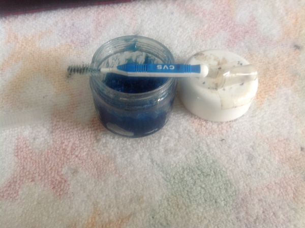

Good John, thanks for sharing, I buff the outside of the plates, As Alan said, yamaha marine grease, will shine the face plate, cheers Don.
