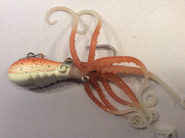

I have been designing and making swimbaits for a few years now.   Spent nearly a month  at Cedros as part of my testing.  For calicos, don't be afraid to use a lot of gold.
Sometimes they fished better once the tail got bit off.
THe yellowtail liked the bigguns. 7 inch would get bit, but 9 inchers would get bit better than surface irons.
