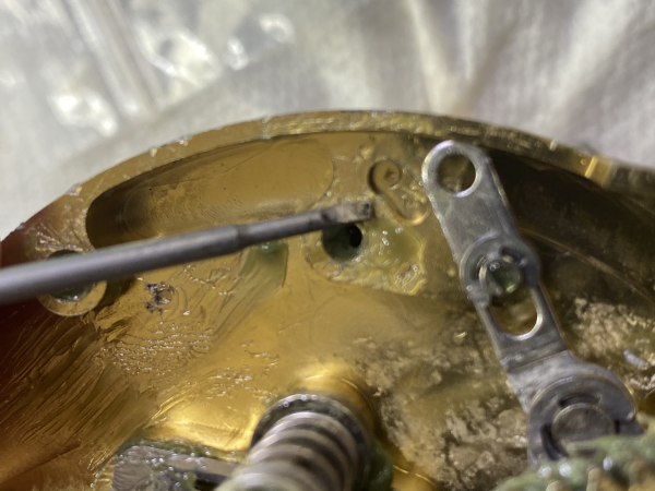

Any tips on getting this back together?  Both pieces are under load to install, but behind the head plate.
steelhead_killer
Hmm.  Processing... The plastic part is as it came apart.  It has a small lock nut on the screw.  Will not come apart.  So I left it where it was.
oops, yeah, i see that now.  remove this click switch cam (key #2721) from the side plate and seat it back into the one piece frame (key #2916).  you will have to alight the click switch cam with the click link (key #2907) and then set the click switch spring (key #2723) into the tiny hole of the one piece frame.  when the reel is ready to go back together, install the right side plate (key #2881), then the click switch (key #2683), and then the screw for the click switch (key #2228).

Thank you!  The shaft running through is threaded at both ends.  Just needed a little pressure and holding the other end to get the screw from the outside to release.  Thanks again!
