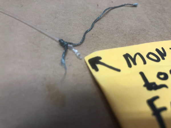

As I struggle with the need to master the knot ,  of course I'd come back here to seek advice before becoming disillusioned and disappointed 😔....
   Some pictures are shown with notes....

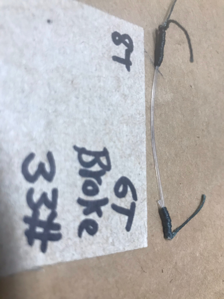

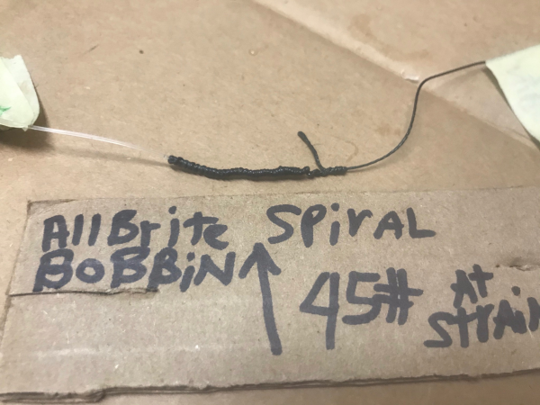

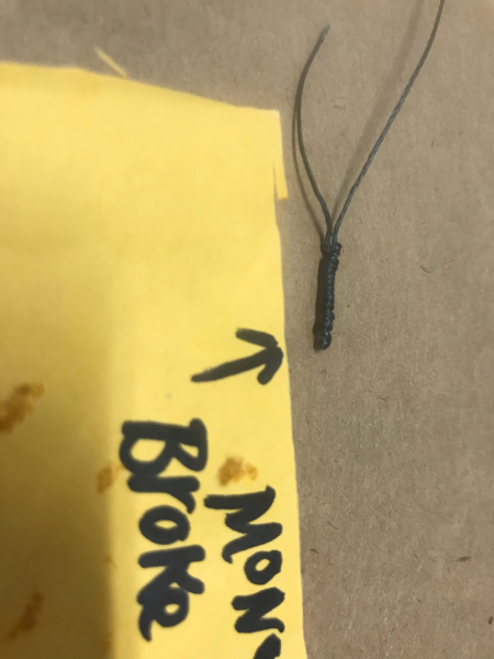

Both of these are 80 to 80# for this post.  And are taken after 40# pulling ratchet strain.
   I'm starting to see signs of possible failure as separation is starting.
Is this normal?   With other knots I don't see this.      More in page 2.
The pointer shows the question area.

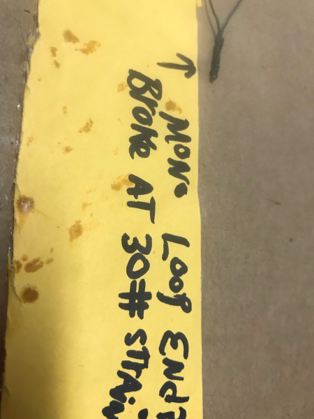

   This knot failed at about 50# constant strain...   the line was tied at each end.  These knots held.
It is above what I would do for drag pressure, butt the knot did fail,   I know something has to give, butt when compared with other connections like the tony p, and improved allbright these knots seem to stay put and then pop......

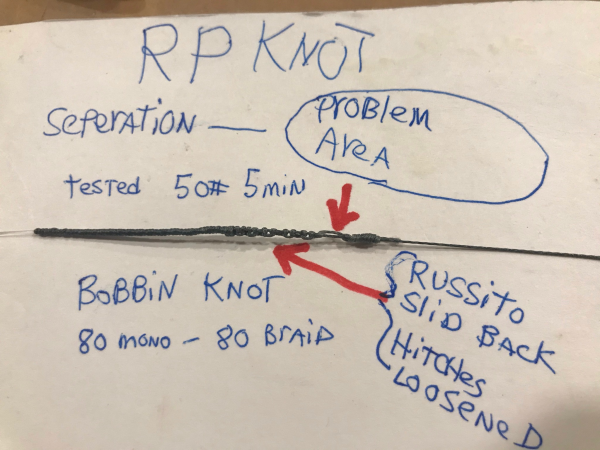

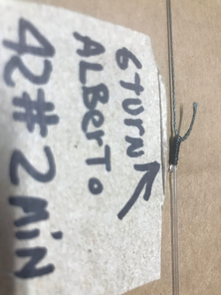

  Below is the visual difference in the Tony P and the improved allbrite.

To me the knots fg , below , looked good but under strain of course everything changes.
   If the braid is not dug in and changed in color it's the problem right?   Too many wraps?
       Too many half hitches?  The photo is under 40 # strain.   It's moving.    Just wondering.

I congratulated myself on finally getting good ties at the bench, but when casting the FG over time, many good looking ties would start to unravel over the end of the mono.  I think that bench testing is not enough to gain confidence with your ties of this knot.  You have to put some miles on it, especially if you cast it through the rod guides.
Gary's looks to me like the wraps were not packed closely, so when tightened, some had to extend.  I predict nothing butt heartache if these were fished for awhile...
