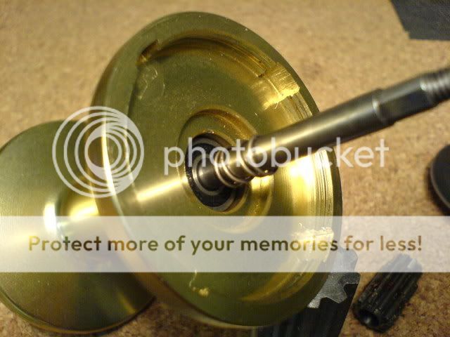

Here is a pic of the flange... there is a lot of extra meat on the periphery that would be detrimental. It is an easy job to thin that out if one has a lathe, but then making an entirely new spool, or modding the old one, isn't particularly difficult either. And then you're kinda back where you started. Maybe just easier.
Well, good luck anyway.
BTW i gotta say, 161 with a 10' is pretty impressive. Mind if i ask how much weight, or if that 161 was on a field or on the line?
PS Afterthought, a little late: No provision for pinion engagement on the LD spool. Back to square one.
