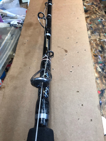

After listening to you and pondering 🤔 if stumbled on a possible
Viola.    Adding the inner size 10 guide to aid in keeping the incoming line centered in the first guide.
   This might just work.
Wow, ya know, maybe you should just stick to conventional wrapped rods!
Im not an expert but seems that the angle of the line from the added small guide is too sharp, the size 10 guide is to close to the striper guide, I think in this case you better off taking the striper guide out and reinstalling it with an offset to the right.
