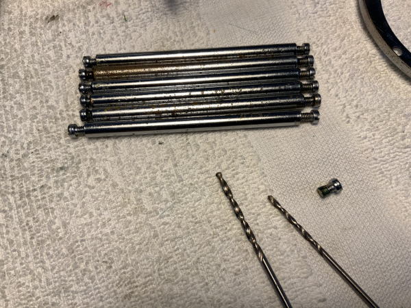

Got a Penn LB 68 and found a snapped-off screw on onea the frame posts. About 2/3 was stuck in the post and someone glued the other top section into the side-plate to make it look good(blue stuff on the screw head in the picture). An eBay seller trick?
Darn!, get a new post? Nothin to lose here, so try a no-"easy-out" way, and see... started with a 5/64" drill, got alla way through the screw shaft, then finished with a 3/32". Musta damaged the threads, right?, ...NO! Cleaned out great. The spare screw went in easy and tight. Used a punch to knock-out the glued-in screw head from the plate. Had to hit it kinda hard. Bakelite is some tuff plastic——no damage.

   Sometimes what looks like an easy fix turns into a major event...while the impossible job becomes a cinch...all in a day's reel maintenance! ;D Watcha gonna do with that big ol' 68?
I love LB's and wanted a line-winder reel--- put-on/take-off line for temp. storage(spool cleaning) and use as an "under pressure"braid winder-on'ner. The 68 has the slow gears (2.5:1)---bad, but is easy to service/modify and has great line capacity. Also this perticular 68 had the 24-56 penn power handle(me like!) with a cool 113H size butterscotch knob.
Be interesting to see if I can duplicate that fix. Went slow, used oil and moved the drill back and forth abuncha times. Maybe just lucky?
