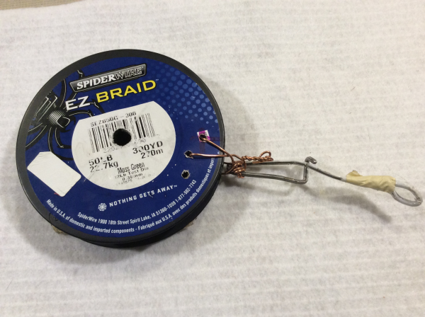

first picture: tag end of hollow braid

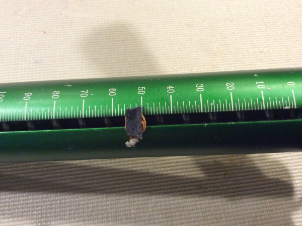

second picture : insert wire loop about 6-8 inches from tag end going away from the tag end
third picture:  another picture showing the wire 8 inches inside the hollow braid
fourth picture:  exit the wire thru the hollow braid

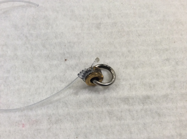

first picture: bring end of wire thru the loop in the wire
second picture: continue by taking the tag end and teh rest of teh wire thru the wire loop.  It should flip over at this point.
third picture : adjust the wire loop and pull it slowly until a small loop is form in the braid.

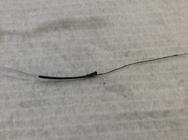

fourth picture: continue pulling until the braid turn completely inside out and form the loop
