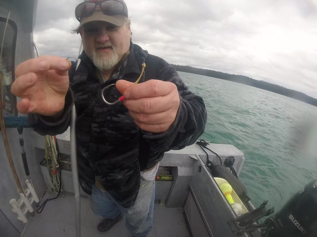

 Another personal choice when jig fishing is when to use split rings and welded(soldered) rings.   As split rings come in a lot of sizes and can be added or changed out on the boat or on the beach,  welded ones are permenant until broked or cut off.
  Both have some advantages and disadvantages .    Large split rings can be a pain to change or add especially to large hooks with a fairly thick wire eye.
https://hosting.photobucket.com/images/p660/gst6814/GOPR1832_Moment(3).jpg?width=1920&height=1080&fit=bounds
   Ive seen a few failures with welded rings,  and with split rings.    I do my own soldering on my welded rings and that was a learning thing.
       Like knots we like to pride ourselfs with being darn good. 8)  Even now i dont pull test with a scale most that "look good"  and its easier sometimes to cut a suspect ring off and redo it.
  The above link is to a picture of a very suprised camper on a boat i was on with a failure.   A good fish is gone,  as is the jig. >:(
Anybody else had failures?   Any ideas to advize us on?     Thanks  gst.
