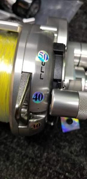

I hope anyone can help me. The line guide of my 965 will result in a very asymmetric line lay: See picture...
What is the reason for that? And what can be done?

I honestly do not see where shimming anything would result in a different lay of yor line .
 Couple of things come to mind after looking at you picture .
1. was this particular line lay done with pressure on the spool as in a fish  on ?
2. Check to insure the level wind is Not Binding as it hits the ends on each side before it reverses direction .
3. Tie the  line to a fence or Tree or drop in Deep water ,Whatever it takes  to empty the spool and start over to see how it fills the spool back  and make sure you don't have some tape or something on those places on   each side of the empty spool causing the line to bulge up (I know that sounds odd but still without knowing the condition of what the line is spooling on  you have to start somewhere

From the photo, it is clear that your spool is protruding too much from the right, so the line is bunching up there. You need to align it so it is more centered. Not familiar with this reel, but many reels (like Ambassadeurs) have adjustment knobs for this purpose.

Good Eye Nelz ,that Most likely is the problem.
I can't really see much difference in the angle  of that pic  on my screen
How about posting a better straight on picture of the Reel .

Check the manual adjustments that could align the spool. Inspect for burrs in the worm gear or a worn pawl. The gradual stacking of the line on the right in the photo is a clue.
It is notable that the spool seems off-center in the frame.
Also, look at the lower fill of line on the far left side of the spool.  The gap on the left almost equals the spool reveal on the right.  To me that means the line guide can't reach the far left side of the spool.  At some point that edge of the stack will rise and line will fall into the gap and cause more performance issues.
Looks like a spool issue to me, but I would still eliminate the simple outside mechanical possibilities before going inside.
I'm interested to hear what you find.
Yes, this is what I had seen before as well. And I had also suspected that this is the reason for the asymmetrical line lay.

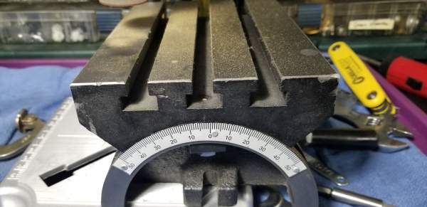

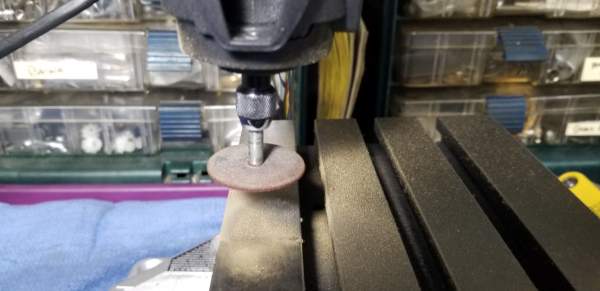

 Glad you got it fixed .     I want to see more of this tool , is it 3 jaw ?
Olsi_AT
Thank you  I see now the 4 steps on the jaws , that gave the illusion of 3 jaws .  Nice little tool !!
