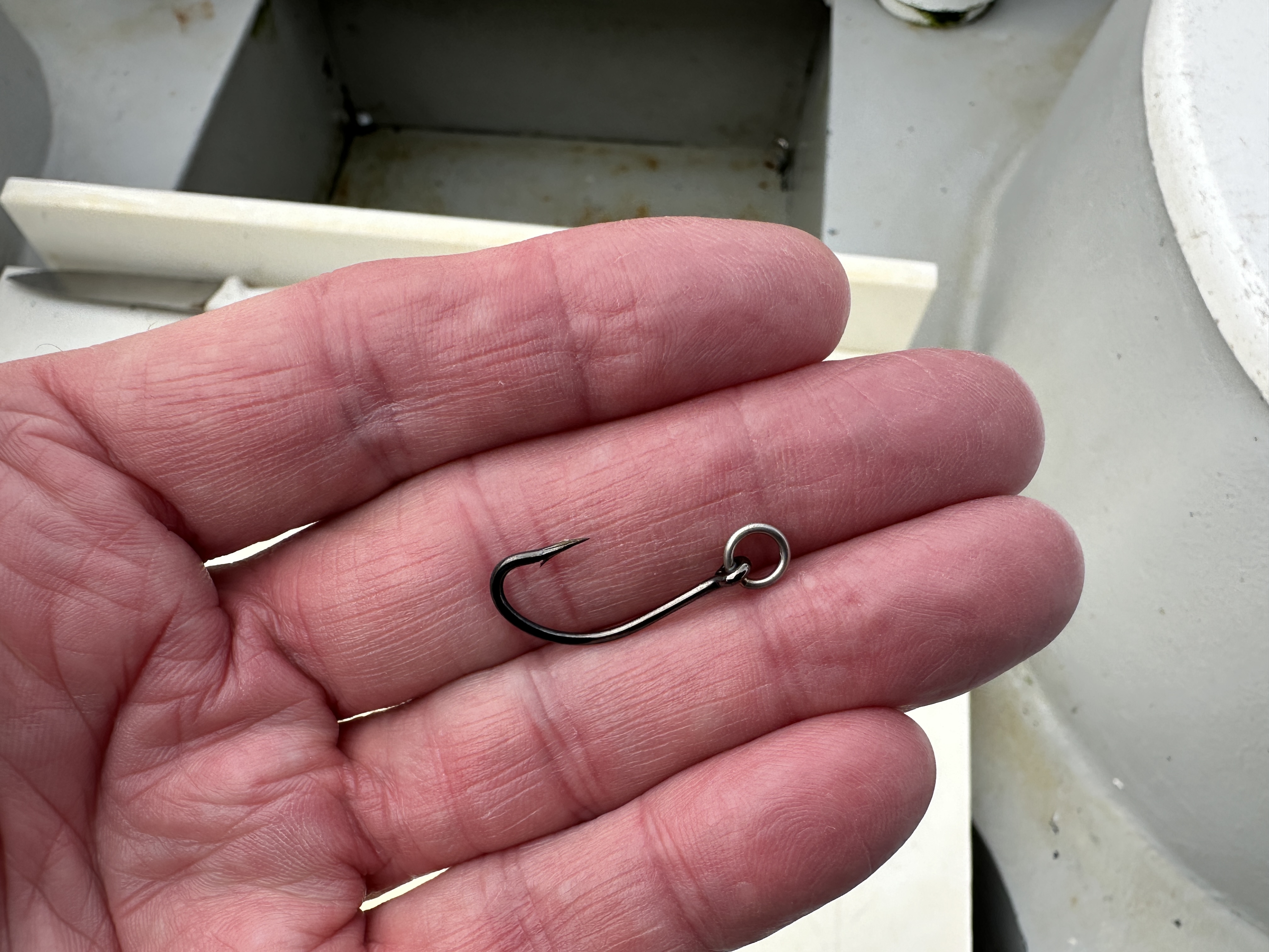

On the boat, checking out the gear - our ONLY point of contact with our pelagic prey is this... a #4 J-hook with an attached ring.  This will catch 30+ lbs. albacore!!!!!

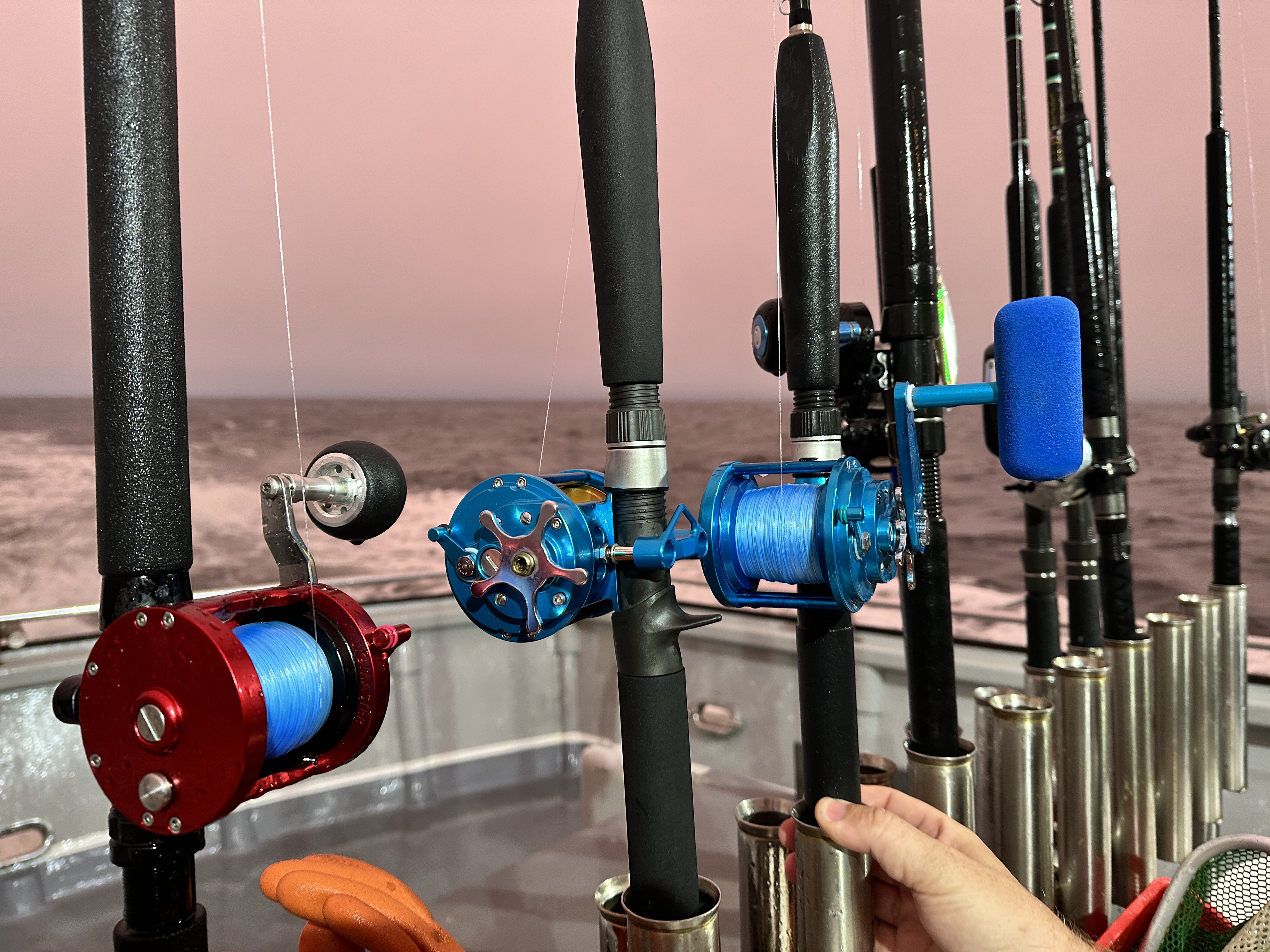

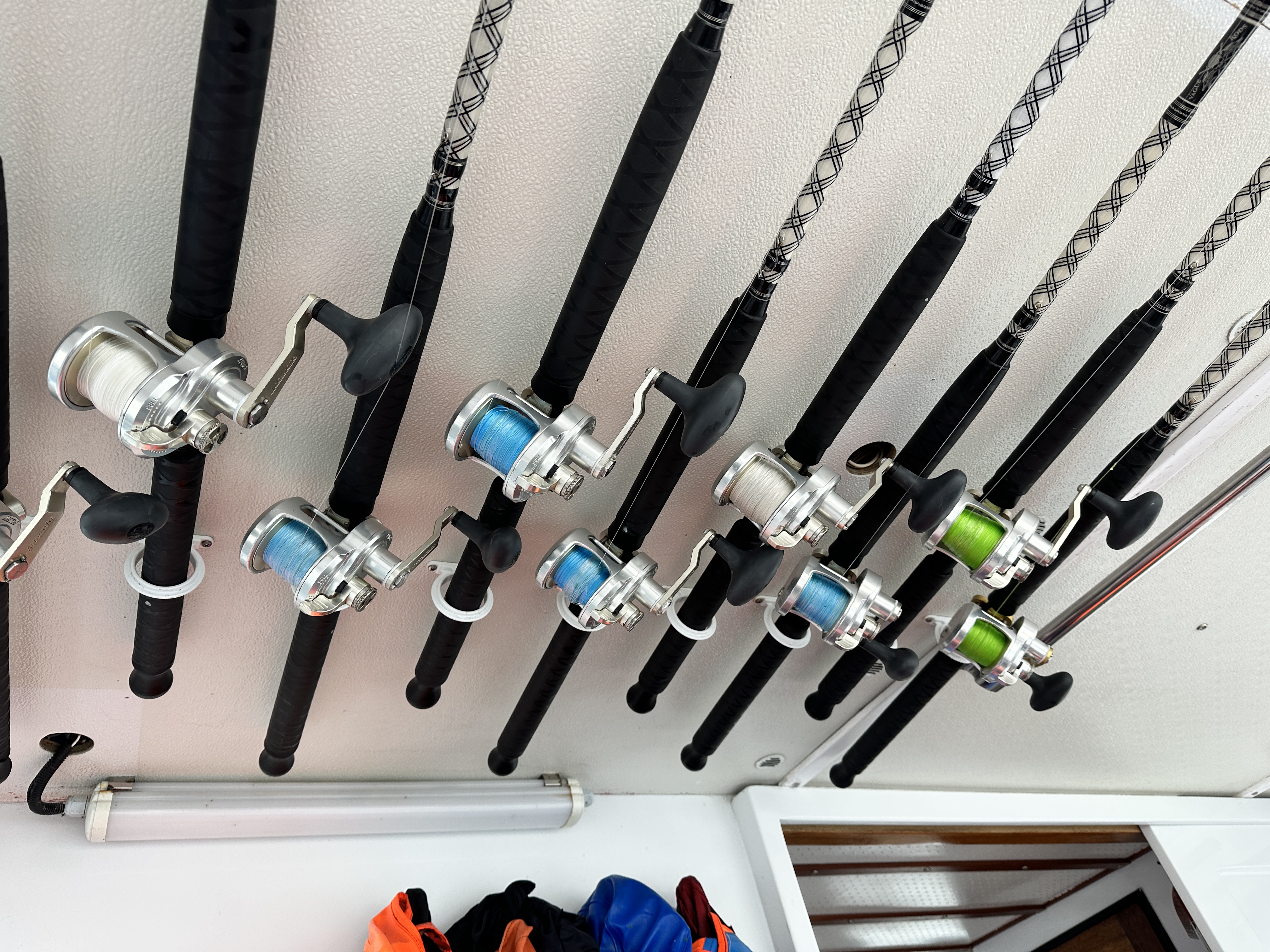

Rods & reels were 6 1/2' rods ALL with Accurate lever drag Fury 500 Reels with 50 lbs. braid and 25 lbs. mono.  This worked perfectly on our trip.

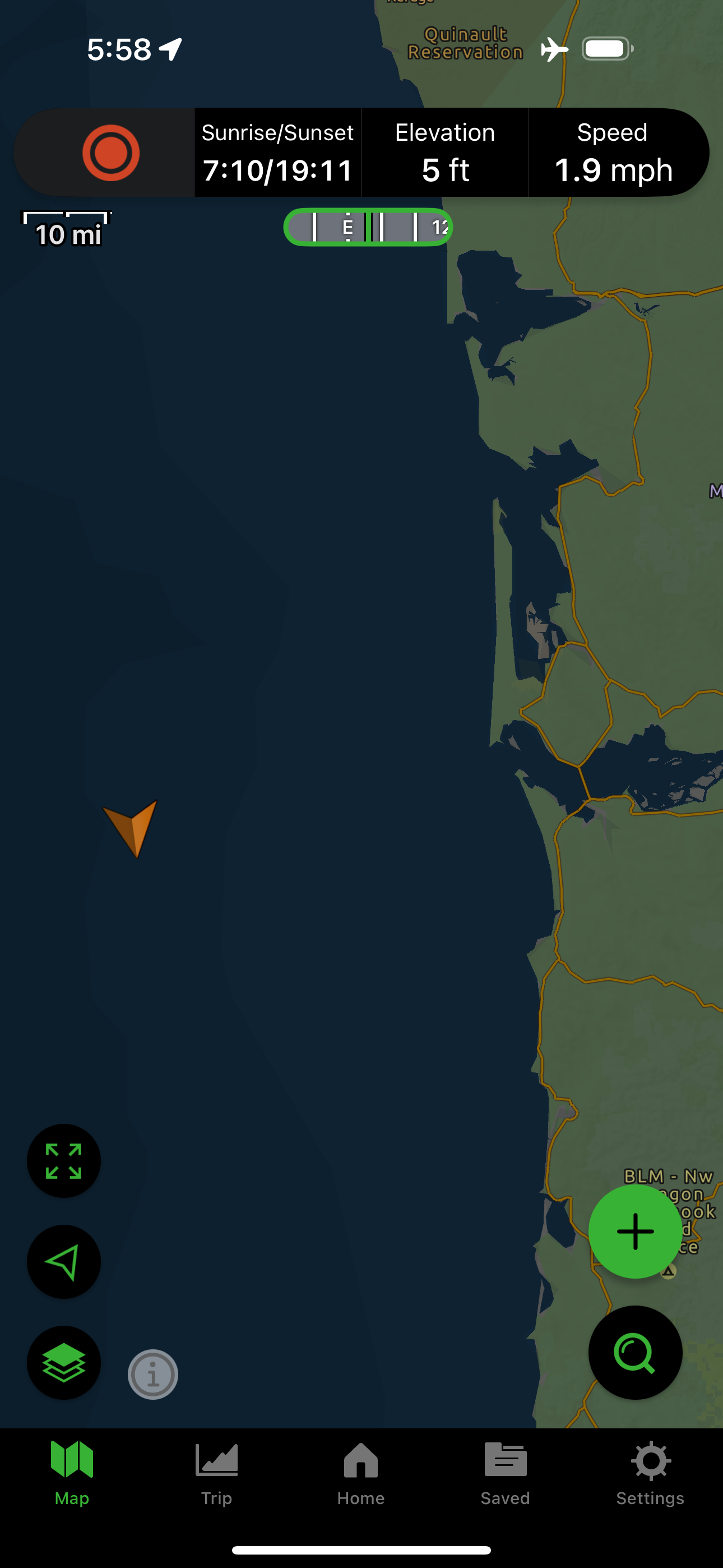

I use the GAIA app on my phone to GPS our location wherever I travel.  For most of our trip we were 50-70 miles offshore.

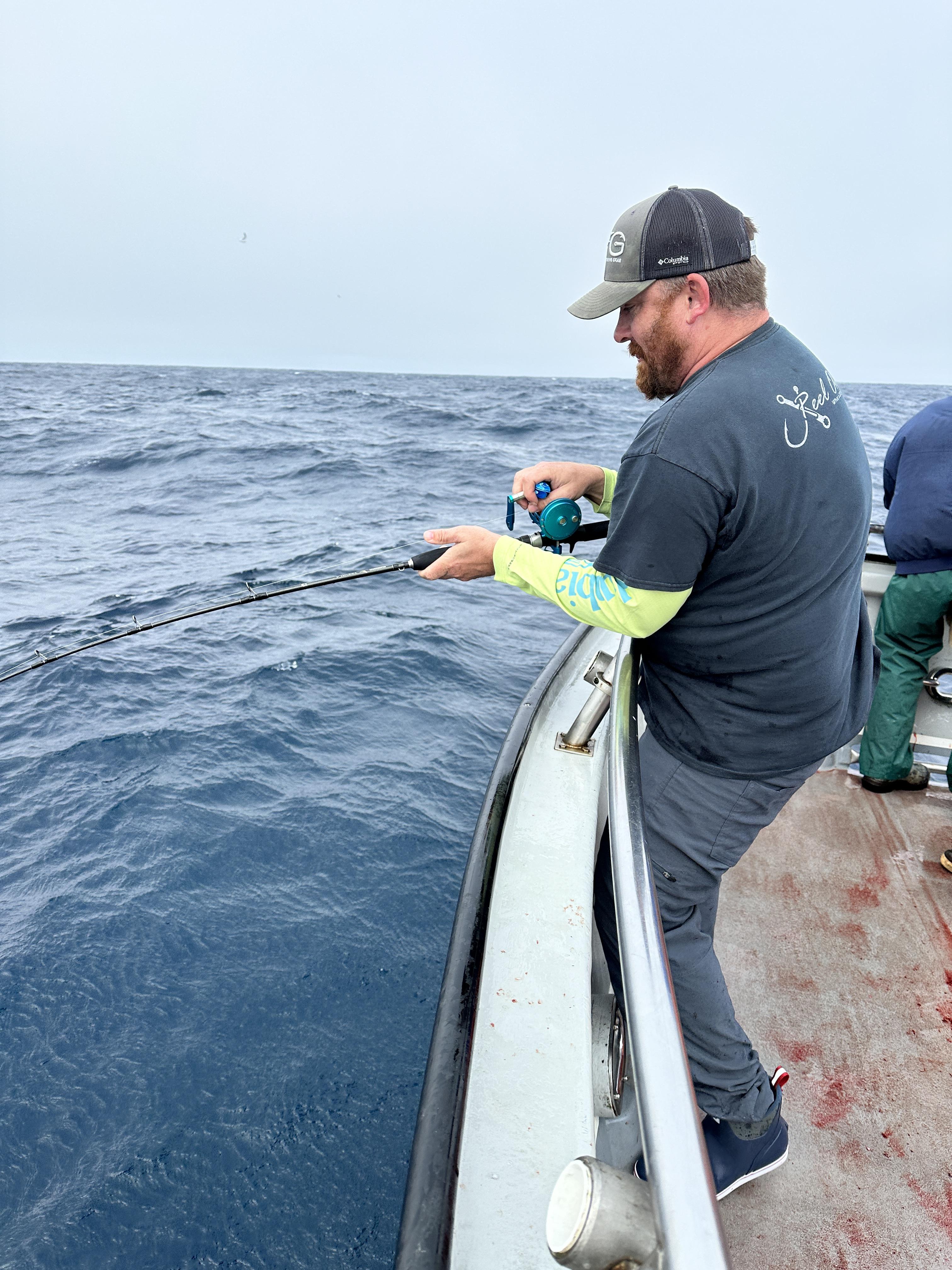

On this trip I took so few photos, like the rest of us - I WAS FISHING!!!!  But for some reason my gear in the holder and took a few shots of Nick Poppen fishing.

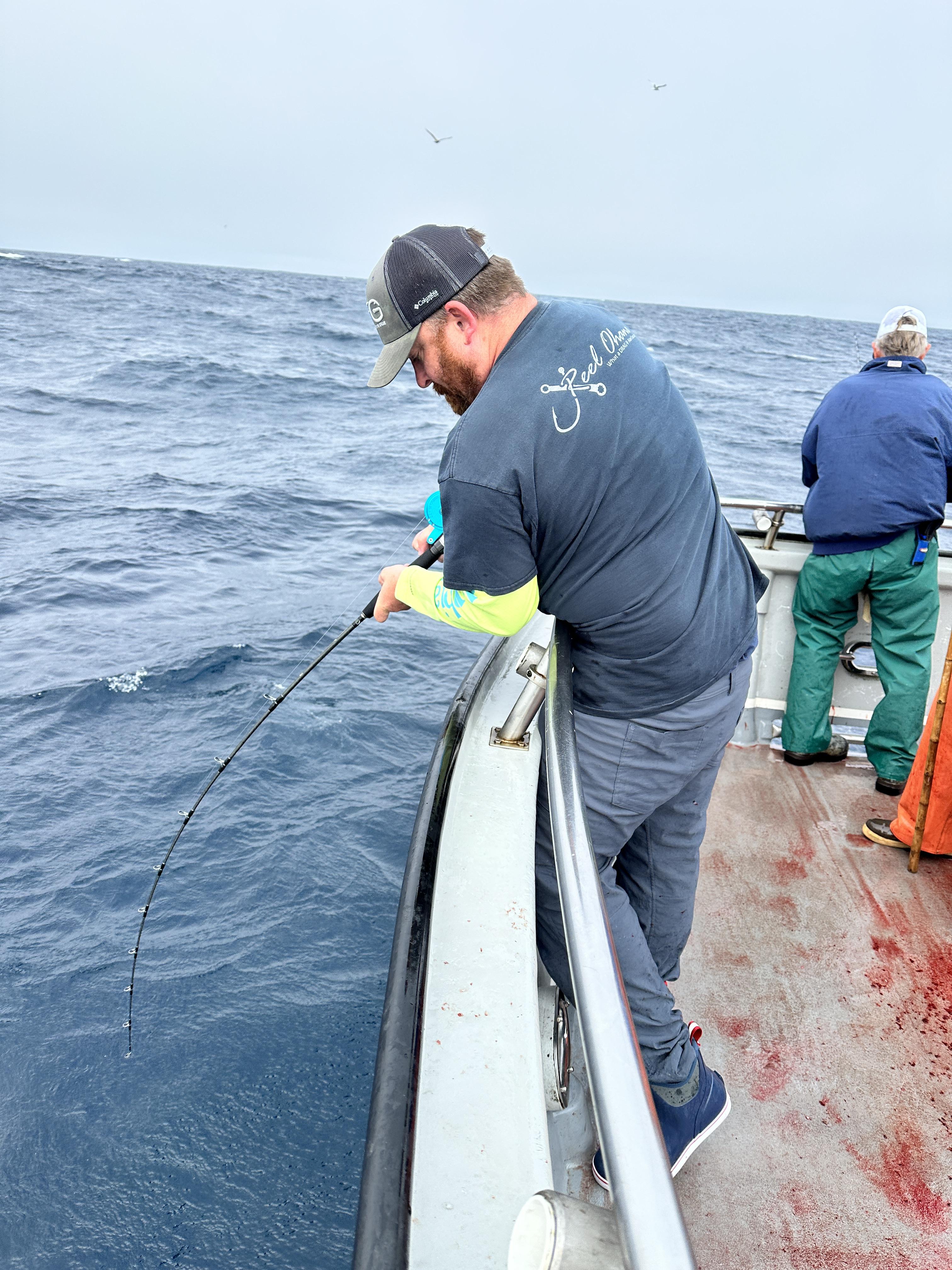

Something happened and Nick's Crank arm and handle CAME OFF  HIS 500 Reel!!!!!!
here's a close up
Nick, mentally prepared, threw the crank arm and handle on the deck, laid the rod on the rail, and HAND LINED this fish to the boat, where the deckhand gaffed his hard fishing fish!!!!!  Nick, when you have time, we would LOVE to hear the Post Mordum on WHAT the heck happened here????  I looked at the crank arm, and the Handle Lock Screw (Set Screw) was screwed into the Crank Arm, but the Crank arm came off the reel!!!!

Custom (THINK Cortez Conversions) Penn 500 reels are what is needed.  Again, Nick what happened to your handle????

Cortez_Conversions
Looks like the handle nut broke. Is the threaded half still in the gear sleeve?
I've done this once on the bench trying to get the nut aligned with the locking screw. The handle screw is brass and will stretch to failure. I replace them often, just for this reason.

Quote from: Cortez_Conversions on October 07, 2024, 01:13:51 AMLooks like the handle nut broke. Is the threaded half still in the gear sleeve?
Tom, Is brass the only way to go on the nuts cap screws?

ReelFishingProblems
So there I was, a fish in the line with one hand and a disconnected handle in the other.
What happened:
The handle nut popped out of the gear sleeve while the handle lock screw was still in place. The inside of the gear sleeve was stripped and the outside was rounded. The inside of the gear sleeve hole on the blade was rounded out as well.
The blade was originally a very tight fit on the sleeve and I must not have done my due diligence in assuring a proper fit. My guess is I didn't seat the handle fully and the handle nut was not screwed in deep enough. While it was as tight as I could get it with the wrench it must have been the problem. Nothing else makes sense.
There was no damage to any of the other internals.
I chock it up to operator error.
Rocket Dog
#132
Ahh, thank you for the postmortem and a good reminder double check all the connections. It appears that a SS selve would have helped in this situation.
jurelometer
May not have been an assembly issue.  That gear sleeve to handle junction is the weakest link on a Jigmaster with a stock brass gear sleeve.
Once the handle/sleeve junction rounds out, that lock screw ensures that you will be continuously tightening the brass handle nut as you wind under load, so it would eventually break like this.
A stainless gear sleeve is the key upgrade.  A stainless handle arm would be stronger (but heavier).  A stainless nut would be nice too.  Don't remember if it is an oddball thread side, so not sure how easy it would be to come up with something from an off the shelf bolt and a bit of grinding.
But the gear sleeve upgrade is the key.  Might be all that is needed before you hit the new weak link (bridge post flex causes gear shredding).  Making other parts stronger  that are not the weakest link doesn't always buy you much.
-J
