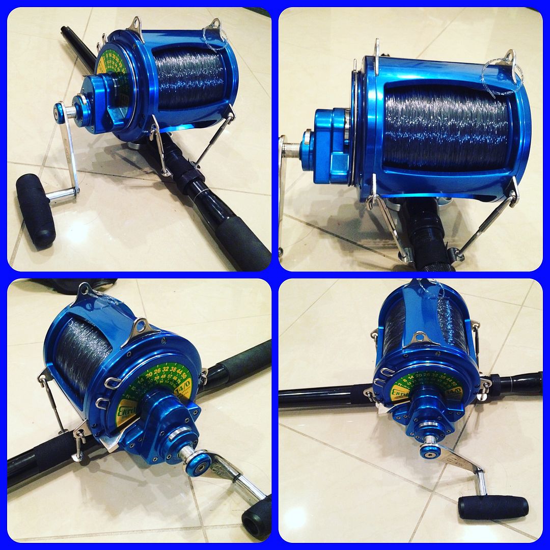

Got my 14/0 spooled up. 1200 yrds 200lb JB and 480yrda 210lb mono (1.38mm ) . It took FOREVER! I taped my handle and it took some of the wear off my hand.
When you decide to give your a braid backing I'll send you a spool of mono to top it off 170. 210, 250 or 300lb.

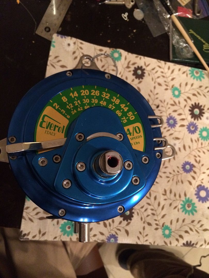

Hello , and ya its a pretty blue, reminds me of the wifes Avet, and hopes yours is as lucky!    But what is the twin loops on a kind of round snap ring thingee for?  on the crankside?   Just wondered.   Anyway I hope you get many long battles with this masterpiece!
Lowprofile
Quote from: gstours on December 13, 2015, 05:03:33 AM
Drag limiter. You can set it so if you let someone take the rod they don't push the drag too far. I set it at that setting for storage. Always store with the drag disengaged, that's just to prevent it from getting knocked forward. Takes 2 seconds to adjust the limited and only one finger.

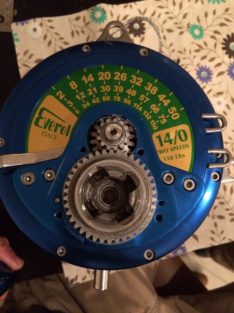

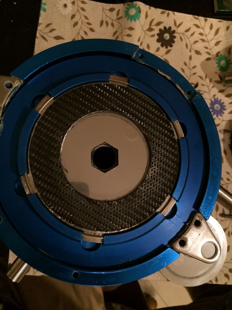

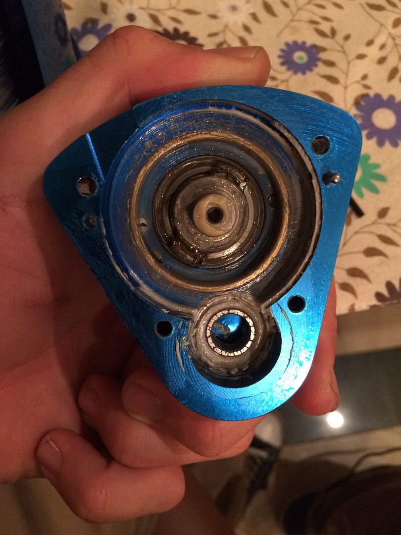

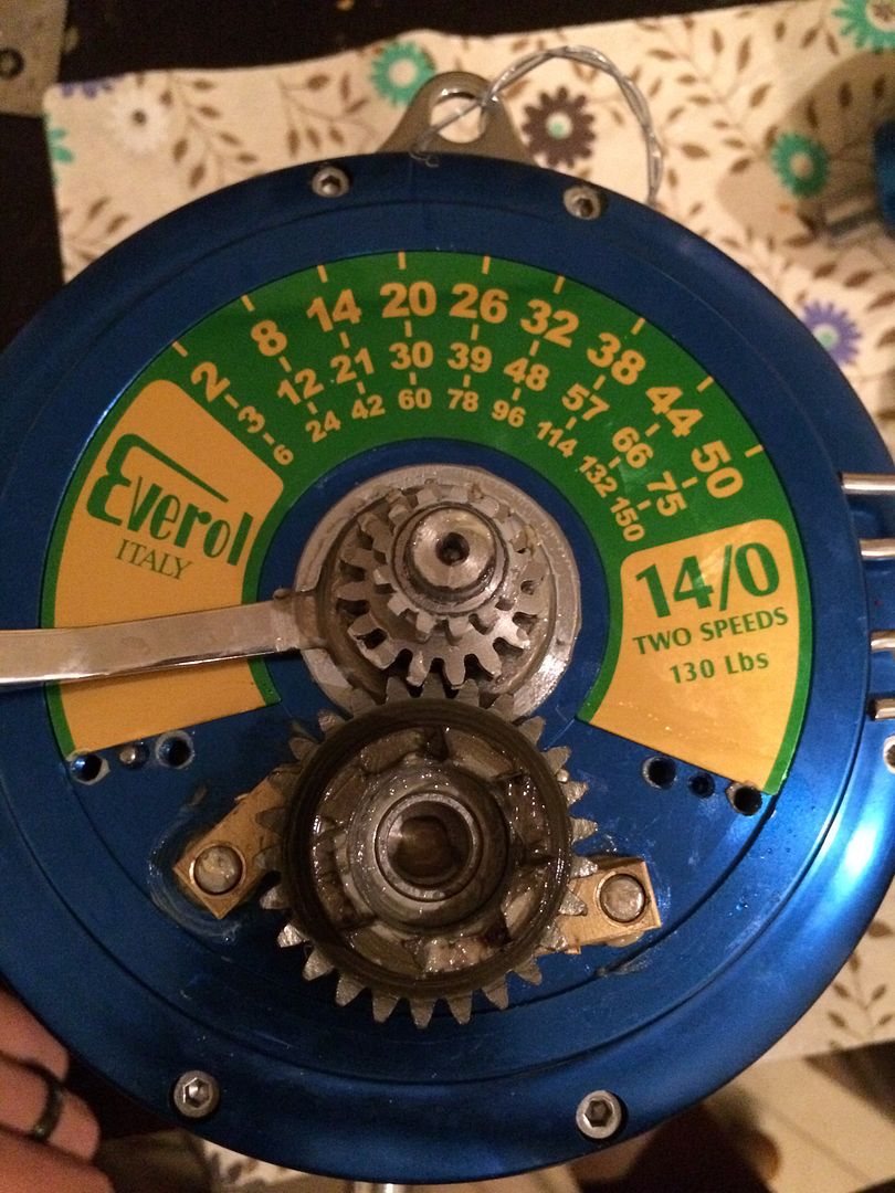

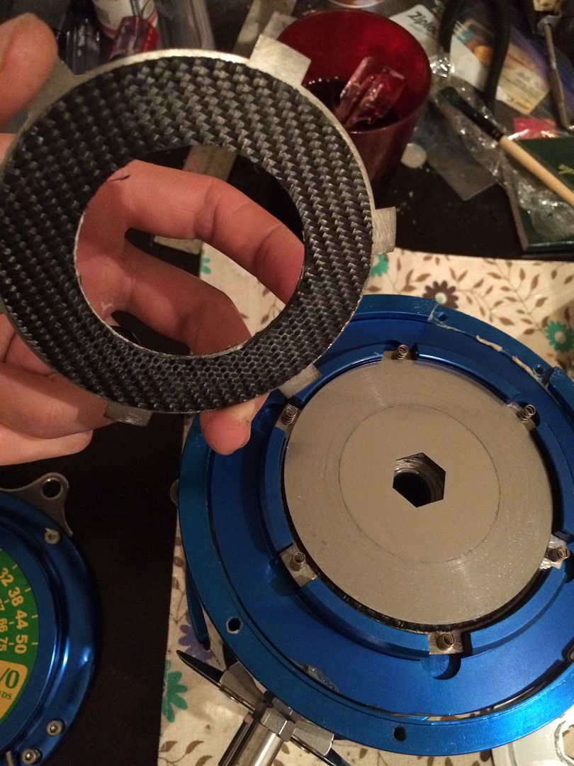

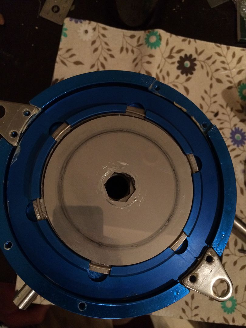

took a peak inside. greased the metal on metal conections as I reassembled it and put some cals on the drag. just enough to cover the drag and then rubbed it in and wiped all the excess off and left it looking almost dry, but there's some in there.
this is taking it apart. didn't take pics of the left side. ill do that next time.
double sided drag disc
removed the stainless disc
all the springs. and of course I knocked the reel after this and they all went flying on the floor. wife and friend laughed at me for a good 20 minutes.
took the spool out and the two bearings on the other side (spool and thrust) were already greased. seems there is some kind of corrosion protectant on the metal surfaces already but I hit the seams with grease anyways and greased all the screws. the base (reel foot) was already greased and locktight on the screws.
