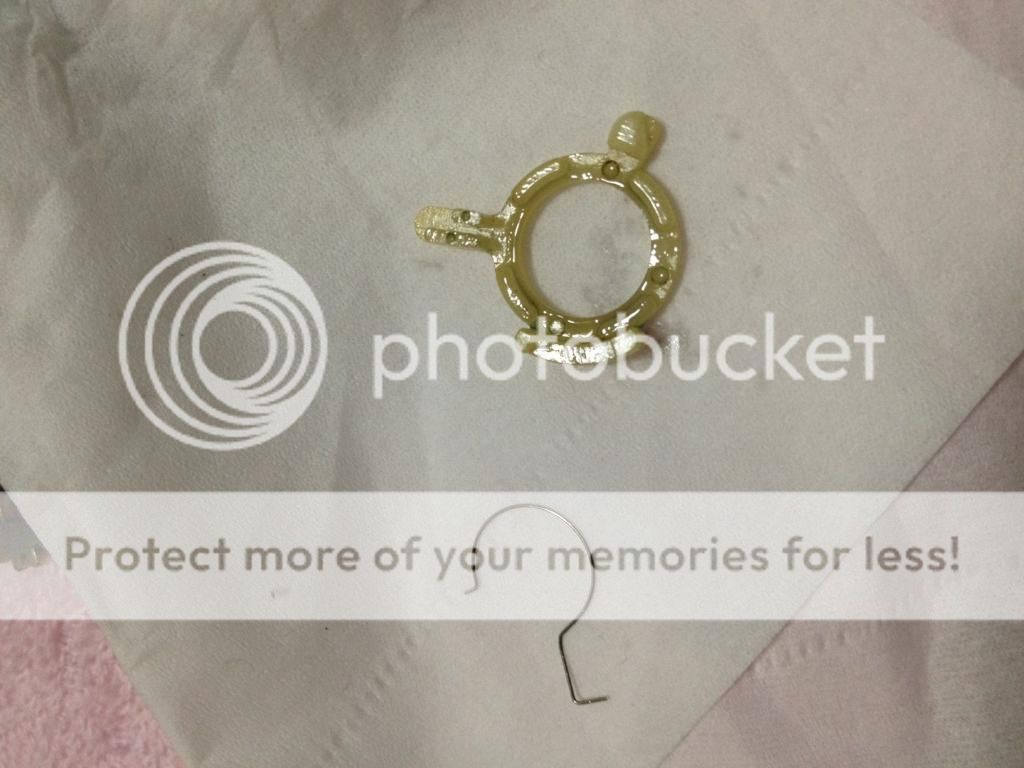

Hi Guys,
Please Help.
I was doing a rebuild of a old Daiwa spinning reel (emblem-x 1500TW).
It has an old AR Dog design (will try to post pictures tonight).
The spring suddenly jumped on the AR Dog before I can take a photo of the orientation of the spring for re-assembly.
Can anyone post a picture on how the spring is mounted on the AR Dog on old daiwa spinning reels.

It looks good to me. It is working correctly now?
The spring is a friction ring that keeps tension on the anti-reverse bearing so it won't go backwards on you. It moves the plastic piece you are showing in the right direction to keep pressure on the roller bearings inside the clutch bearing.

not working properly  :(
When I have a fish on I can hear it clicking
I was thinking I installed the plastic part wrong or the spring
Not sure how to correctly put the spring since it jumped the first time I opened the reel.
The schematic that came with it was wrong and was showing a different reel.

Gonna try and give you some help based on "basic principals" on how the spring is intended to work...
There are two "lips" on the spring. One at the base of the circular portion is to position the spring around a hub/housing. That first lip keeps it from rotating.
The second longer lip (arm really) is the one that should interact with the plastic bit over the AR bearing to keep it in tension. If you puzzle out those two interactions it should fit only one way.
The other appears to be the lever that moves it in and out of position.
Hope this helps. More and clearer pictures would help us too. :)
