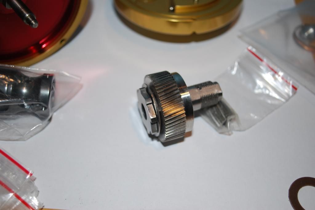

When discussing 5+1 drags, I can't see that anyone has tried the idea of putting a keyed steel washer at the bottom of the gear sleeve and a carbon drag on top of that before the main gear is put on to of that again. This will require some modification to the gear sleeve. You have to file it down flat on both sides so that the keyed washer can go all the way to the botton up against the ratchet. Will this work, or will the main gear be pushed off center on the sleeve so that the gear teeth breaks?
maybe a narrow key slot on one side is enough to keep the keyed washer from spinning? A steel washer and a drag washer below the main gear will do nothing if the steel washer is allowed to spin on the gear sleeve.
Something like this:

I don't believe the washer at the top of the ratchet needs to be welded, it could slide in as the latest and do just fine. Not so much for that carbon fiber washer there, I'm a strong believer that it should be a Delrin washer.
I'm gathering parts for my Huber Tank ;D, I liked the idea of that thin keyed washer  at the bottom of the gear so much that I made my own sleeve for it.
and the .20mm Delrin on top of it
This is a good upgrade.

Sorry Bob, no I did not make my own sleeve, I could never do that, I meant to say I filed the flat side all the way down to accept the keyed washer on top of the ratchet.

I know that they will do just fine, I've tested those already on others. Alan has the sleeve already available, I wasn't sure that he also has them for the 6/0, so I filed down my own, more to just give it a shot.

Bob, flat sides don't go all the way down, I did mine by hand its about feel and can't really tell you how I kept it square, Just put the sleeve in a wood vise and keep an eye on it as you use the file.
Although I'm not crazy about the one notch on the sleeve shown above,I don't believe it would last very long, but Trond has a valid point about having two sides flat, I don't believe it would be a problem on Jigmasters and probably on others, but on larger reels it might. We'll need to test them on the water and see.

So the second part of the question would be...the washer + the delrin washer thickness has to equal a cf or the original penn plastic washer thickness. Did you custom made the keyed washer. What thickness?
Penn stock washer for under the gear is .80mm. Bryan's keyed washer is .50mm, the Delrin is .44mm, giving you .94mm. If the washer for under the gear is 1mm or less, you will do just fine. I just checked the gear and sleeve again, the ones with the flat sides going all the way down as the same tilt as the one without. Gears wouldn't tilt when drag is tight,if they did, it would have been a problem on many reels.
Most gears are lose on the sleeve and perform just fine.

You are right about that one notch isn't going to hold up to the loads. It will shear off, but if you use two notches, it will hold. Strangely, the simulations says it will be more than twice as strong. This may be caused by more even distrubution of forces.
The first image is 0.6mm 316 stainless steel subjected to a torque that equals 5 lbs drag on it's own, in a reel with a spool filled to 60mm dia and 4:1 gears.
It is earlier stated that each drag surface generates about 5 lbs of drag, so I think this is the value to use.  A better steel will make it even stronger.
10lbs drag on each surface will make the soft 316 steel deform.
However, as the second image shows, using 15-5ph steel heat treated with the H900 process will be more than strong enough by a factor of 7.76, for 10lbs drag on each surface.
I'm not sure the gearsleeve is thick enough to mill the grove in it and still be strong enough.
