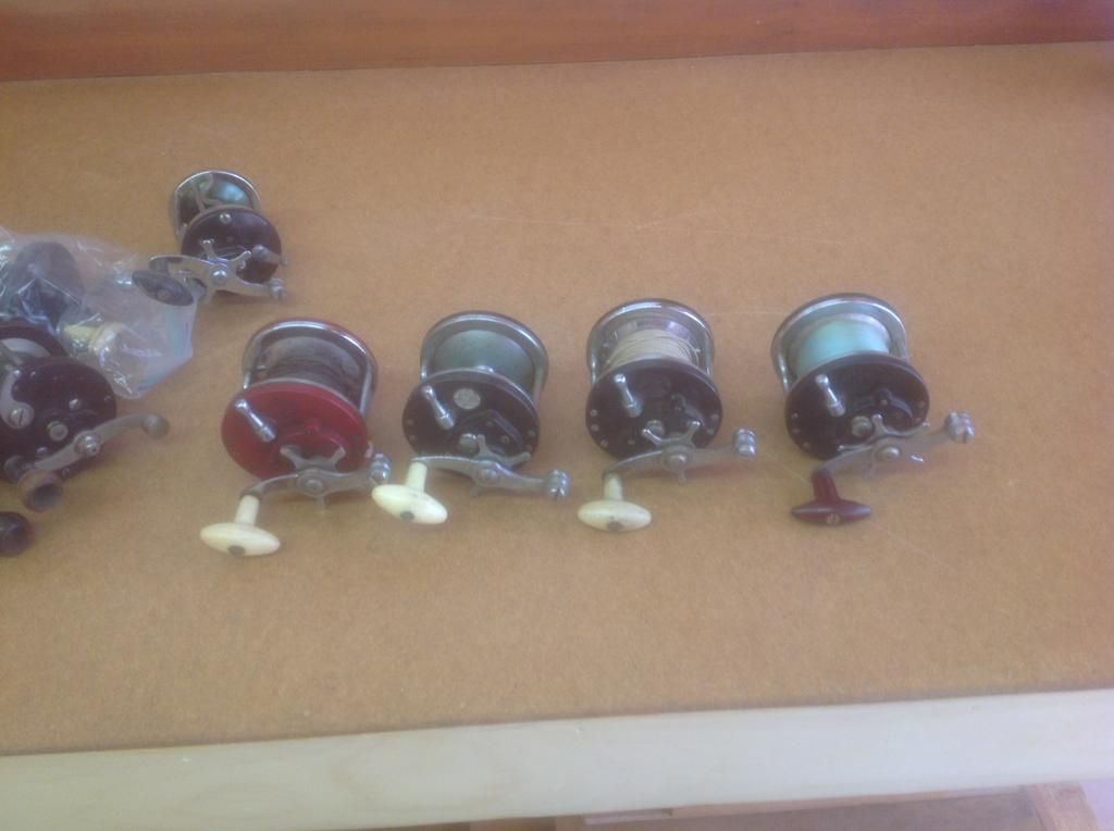

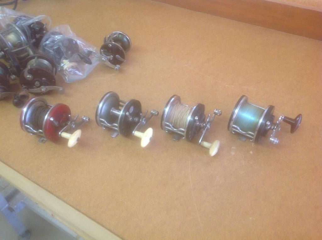

If you cannot find a 112 easily -- I have a bunch of OCs.
The 4 pictured up front are all 112s -- but the maroon one has someone's name scratched on the left plate.
All work well -- and handles are intact and good.
$15 + $7 shipping in lower 48.

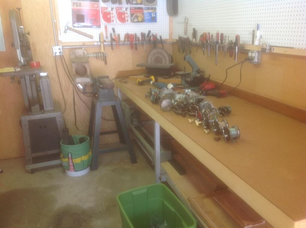

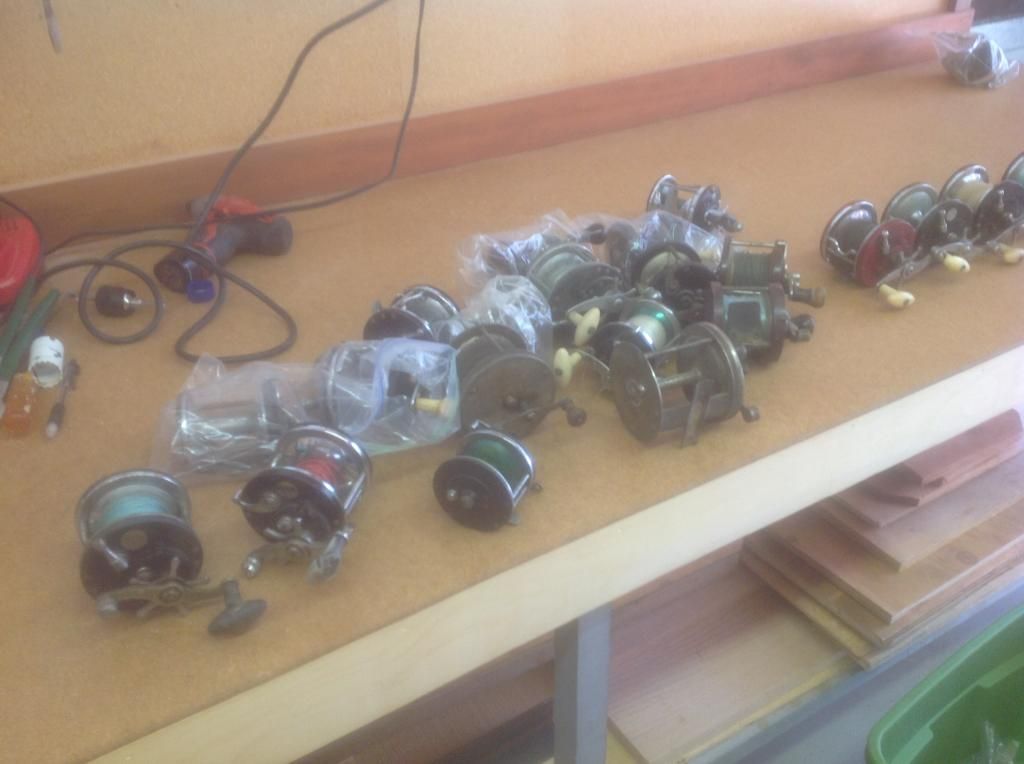

I just brought home from storage 2- OC reels. Neither one has a Star Drag. There is so much dirt & crud that I can't read the model number. They both work a little but they are low on the repair list.
Yeah, Mike --
Probably have close to 100.
They are actually very good and solidly simple reels.  Just need drag and handle upgrades.
I do have a lot of respect for them -- just hate the weak handle knobs that tend to desinigrate over time.  And you can only do so much with the little drags.
They were the forerunners of our Penns -- and have fished well over the last 80 years, or so.
My OCs are not allowed in the house shop -- they must stay in the storage shop until they are able to behave themselves -- and act like respectable Penns.  😄😄😄
