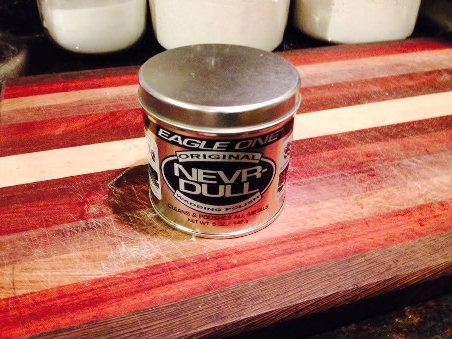

    Since Ted (Max Doubt) brought this can of cleanliness (Nevr-Dull) into my life my reels have never looked so good.
No tutorial needed with this stuff... Rip off a small piece and scrub away, then wipe off with microfiber or the like.
If it doesn't remove the staining then it will not come off with anything short of sanding, which we don't do here  8). It will NOT remove green corrosion or set in rust, but anything else is fair game.
It can be used on any and every part of the reel as a stain remover, side plate restorer, or to make that metal bling.
Be forewarned, use gloves and nose plugs cause it's pretty strong, but you can't get a nicer finish when all is said and done.
Let me be clear, there is NOTHING that can clean a reel better... not simple green, mineral spirits, ultrasonics, car polish or anything else you wanna scrub a reel with.
If you ever look at the reels Ted posts, they all look like museum pieces... how do ya think they got that way? ;)

Found the last can at the local auto parts store  ;D
