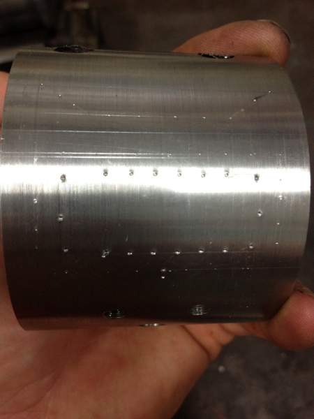

To do the chain drilling, it all has to measured out and centre-punched beforehand. Each centre punch should allow a little bit of overlap. I used a 9mm drill in the cut-out corners, a 4.5mm drill for the other holes, and the centre punch holes are 8mm apart. Note I have "heavy" and "light" centre punches, the heavies for drilling, the light ones are the frame shape profile, helps me to keep track of everything

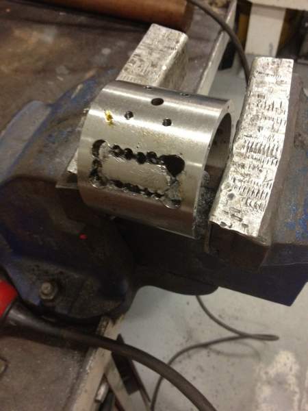

After drilling, it all looks a bit messy. I did have a few holes that wandered a bit.
Any metal left joining the cut-out piece to the rest of the frame was hit with needle files, and I used a sharp chisel to help break up any remaining strands, and to knock the waste piece out
I then used a die grinder with a straight shank carbide bit to grind away the dags, it makes pretty short work of it. I wore thick chemical rubber gloves and a face-shield, as thousands of tiny little needle shards are made during this process. Still ended up with the odd splinter.
Once most of the dags are removed, it's onto the files

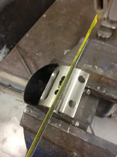

Here I have used an angle grinder with a 1mm cutting disk to cut a groove to mark where I will cut back the frame edges, and chain drilled across the top of one of the cross bars of the frame
I completed the cuts using a hacksaw
