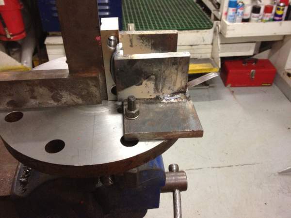

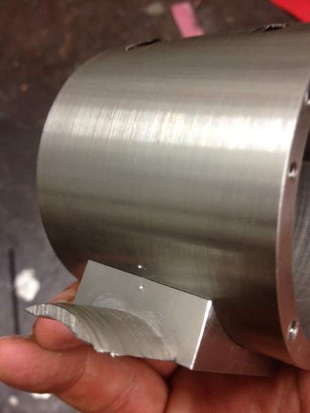

To machine the reel feet, it was yet another tool made to bolt to the faceplate. The curved face with the bolt holes was a piece cut from some scrap pipe that was very close to the diameter of the frame. In the second photo you can see a partial channel cut. I initially tried to take a bit of a shortcut by mounting the piece to the faceplate with the clamping kit I have used at other stages in this project. The problem was the overhang of the small boring bar from the tool post, there was too much deflection and chatter with the intermediate cuts. This necessitated the construction of the holding tool, and thus also having to machine the rod profile in two steps. I'll also add that I was able to maintain a chuck speed of 270rpm without out of balance wobble. Sufficient for this step, and also due to the sturdiness of this machine. If ever attempting this on a smaller lathe, a counterweight would need to be bolted to the faceplate.
The seat bolted to the holding tool with the cap head bolts
Check with a try-square, not quite there....
So slack off the holding tool from the faceplate, and slip a shim in under the tool and adjust until square, you can just see it in this pic
Once happy,  mount the faceplate to the lathe, can do a partial check with the dial gauge for squareness of the faceplate, I managed to get it under 0.1mm...good enough. Do a rotational  check by hand with the machine out of gear, before commencing machining, vital safety step...
Bore cut to roughly the middle of the seat, virtually no tool deflection or chatter this time around
Reverse seat on the holding tool, do some checks for squareness etc with measuring tools and light cuts to get everything aligned before cutting to final profile
Then change boring tool for facing tool and carve out the taper at the top of the footing
This took a while as I didn't bother to cut away the excess metal enclosing the bolt hole of the original piece. You can still see a remnant of this
When I removed the seat to reverse it for doing the other end, I used a grinder to remove the bulk of the metal. Note I have rounded off the sharp corners as well
Re-attach to the holding tool
And machine the other end. I used a 5degree taper, but at this point I'll have to re-mount the seat again, as the feet are far too long, and I want to increase the taper. I plan on filing the width back of the feet as well.
