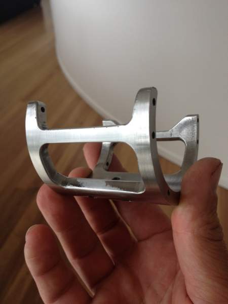

Getting close to the polishing stage of the frame. I have been able to fit in a bit of time while home to refine the cut-outs with some filing, just an hour here and there.
Also narrowed and shortened the seat feet (poet and didn't know it).
Tools used have been rat-tail files, couple of sizes and cuts, flats, and 1/2 rounds. Then needle files to do the rounding off. A dremel with a sanding drum has also had a bit of a run as well. Still don't think I'll have this reel finished anytime soon.

I had a bit of a play with the polishing for a couple of hours today.
I used these as an experiment for removing some scratches and smoothing off
I just glued some 200 grit wet/dry to a worn out sanding drum, with Selleys Quik Grip. I had a couple pre-prepared. I keep them lubed with WD 40 while using them. The grit will wear down, but it's not too much of a big deal to glue another strip onto the   Sleeve if need be. Keep them wet, and they will last a reasonable amount of time.
  I then hit surfaces with the mini felt polishing discs for the Dremel. Used  Bordo polishing compound to bring out the shine.
Actually getting excited the frame is almost done.

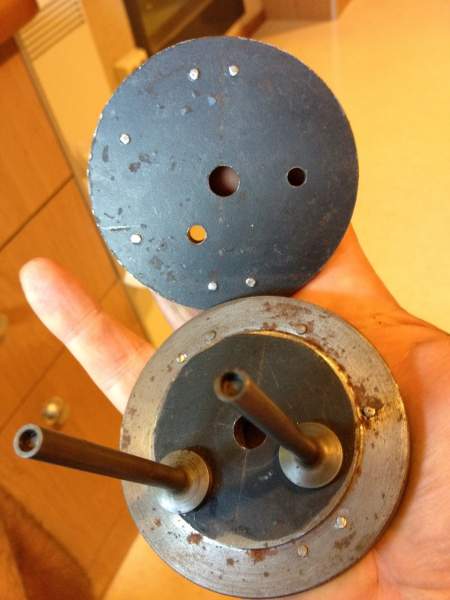

Now to the biggest gripe with this frame (aside from weight). The next photo is looking at the front cross-bar holes (facing the rod guides) with the lock and right side rings in place. You can see what I mean about not aligned. The top hole, not that big a deal, but the lower of the two is a problem, thinking I may have to leave this screw out altogether.
So I'm going to have to redo the frame drilling jig. Rather than go all out and make another, I have simply peened in some 2.5mm welding rod into the original holes to block them up. I will skim the faces of the jig true again, and will carefully use a set of Tom's Cortez plates as my template to re-punch the centres, and then re-drill the jig's holes, and re-check before proceeding with the 501 width frames.
