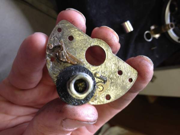

I got around to the clutch lever. It's 2mm SS sheet. The screw is SS M3, and the lever is tapped at the stopper end. The stopper is delrin, tapped M3.
A little blue loctite on the screw before fitting, and down the bore of the stopper.
Tighten it all together
And all ready to go

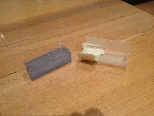

This crude mould was made from a large plastic drill container, cut and taped at one end. It's 65 x 24mm.
Pre-cut fibreglass pieces to fit in the mould. The bottom 6 layers are 450g biax cloth, the rest of the layers will be 450g csm. My reasoning being for this layup, is that the biax will provide the tensile strength where the piece will be under  tension when the clamp nuts are tightened down. The csm will primarily act to build up the slab thickness for machining the clamp shape.

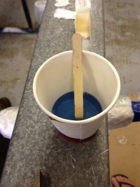

Mix the resin, in this case polyester. After the core piece has been shaped, epoxy and carbon fibre will be layed over this core. The epoxy will bond over this polyester core no problem
Pour a little resin into the mould and let it level out

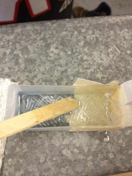

Take first piece of biax and lay into mould, push fibreglass into resin to drive out air

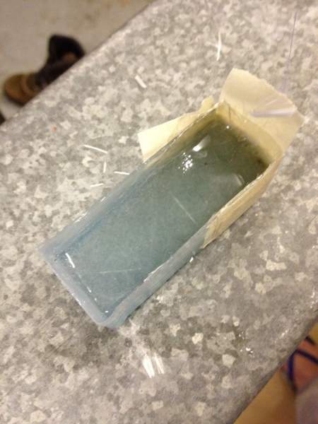

Continue adding a little resin, then the biax cloth. Once the 6 layers of biax are in, continue with the csm.
Keep adding layers until the desired thickness is reached. I was shooting for 18-20mm
Allow the resin to cure for 24 hours, then pull slab from mould.

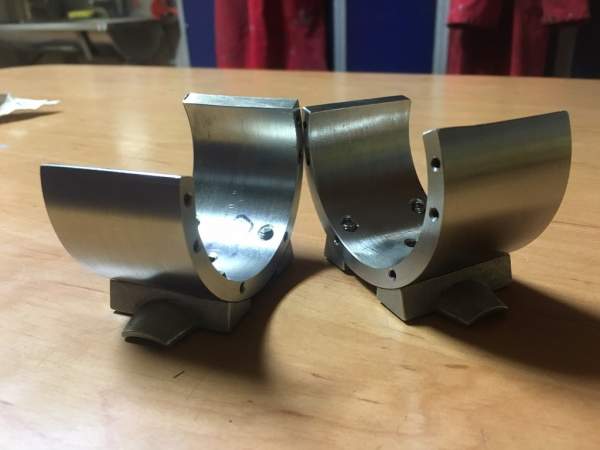

Been busy on the first of the SS 501 frames. Although I have cheated a little this time around. Mike sent me a couple of Penn International 12T reel feet to see if they could be used.
But there was a slight difference with the radius of the 12T foot, just a shade too big...
But there was enough meat in order to re-bore/skim the radius of the SS frame into these stands. Of course, a tool had to be made to accomplish this
The faceplate was skimmed true on the lathe, and the frame diameter skimmed onto the faceplate for reference. The holding tool was then clamped to the faceplate and carefully aligned so the new frame radius could be machined into the seat. You can't see it in the photo of the tool, but there is a jacking bolt on the face of the angle bar that sits on the faceplate to assist with alignment. Tedious to set up, but once set correctly it didn't take long to machine in the new radius with the boring bar, even with light cuts.
The screws to hold it all together are M5, and I used the same method with the 500 frame to hold the seat and frame together while I drilled and tapped the screw holes. You can just see the clamping hole in the middle of all the screw holes.
When finished, one of these frames is going to Mike. He has been a big part of this project with me. There will be a few more Jiggy frames before I move onto other reels. Have a couple of extra twists to reveal in time with them as well.
