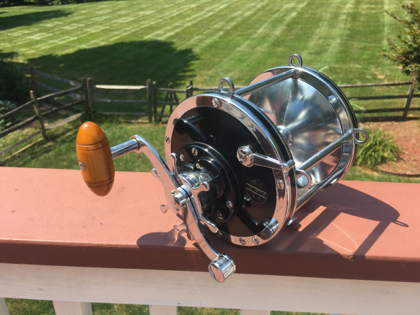

So to go back to the beautiful 12/0 John Taylor posted on page 45 of thos thread, there was some discussion of whether second gen 12/0 existed with a first gen build style (drilled spool). I found one. Pics forthcoming.

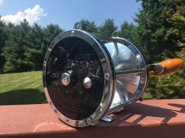

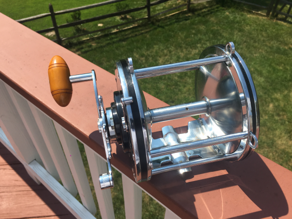

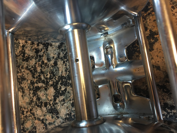

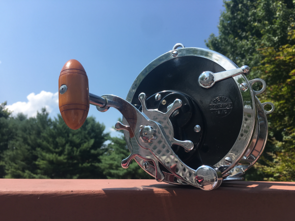

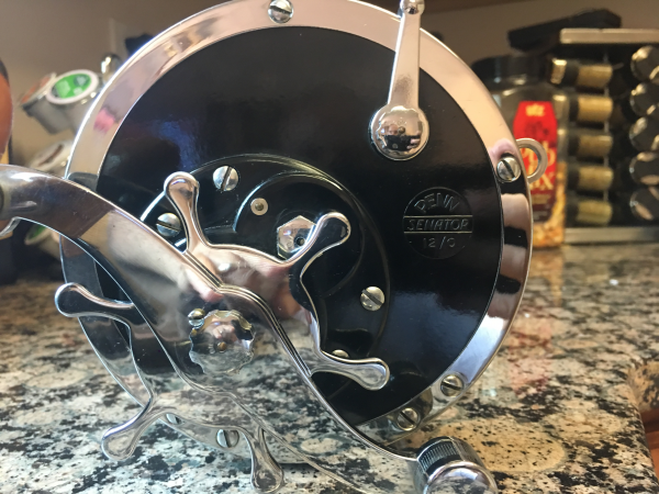

Two more. It is in the second gen build style, first gen logo, knurled counterweight handle with (as Dom would put it) large areola oil port,, drilled spool arbor

Thanks guys! So is the consensus now that second gen 12/0 existed pre war? What year would you say this one is? 1941-ish? If so, is it safe to say very few of these are out there?
Hard to say Chris, but pre war Penn factory was going full bore and increasing production every year until late 1941.
It's my belief that gen2 started in 1941 and many of those reels will have 1st gen components.....like lugs, counterbalance, and drilled arbor spool. It is popular consensus that most if not all drilled arbor Penns are pre war. Coin edge cb is also a sign of a pre war penn
