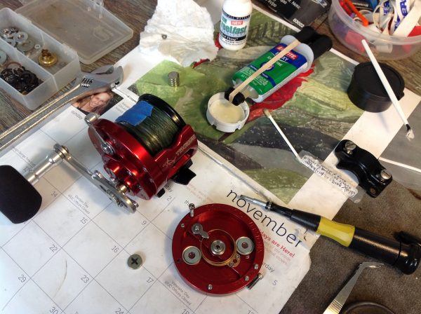

Gfish, I see you're epoxying washers onto the left side plate for the magnets. What is the circular object around the washers? Or have you stacked washers to get the magnets closer to the spool?
Sid
#425
I stacked the washers big, then small then ended up stackin 2 magnets on each. Works but not as good as 4 single washer/mags spread out like I had in the original penn plate. Tom's plates are several mm's deeper than the penn. May need to slow it more, with another combo. Only field testin's gonna tell for sure!
Update: works fine with two magnets stacked.
