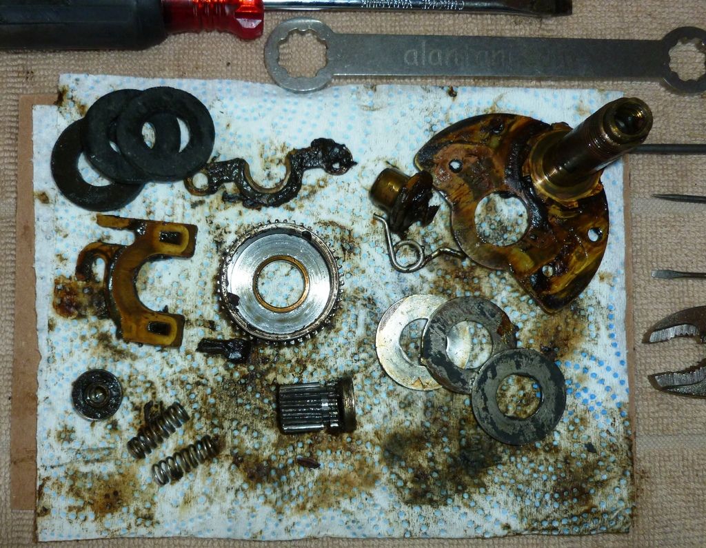

Sid, yep. I just finished breaking it down... I've seldom seen anything as sorry, it's as if some total idiot poured used motor oil into the works, used it to pound nails into concrete, and then left it submerged in the bay for a month.
That is all true, Aiala...However, what other reel in the world (or ever produced) can take that kind of treatment -- and be restored to a capable and useful reel?
I have absolute confidence that in your skilled hands -- you will bring this Lazarus back to beautiful condition.
Look forward to pics.
Good work!
[/Yes, how about a beforre pic
Aiala
Quote from: thorhammer on January 14, 2016, 07:39:02 PMYes, how about a before pic?

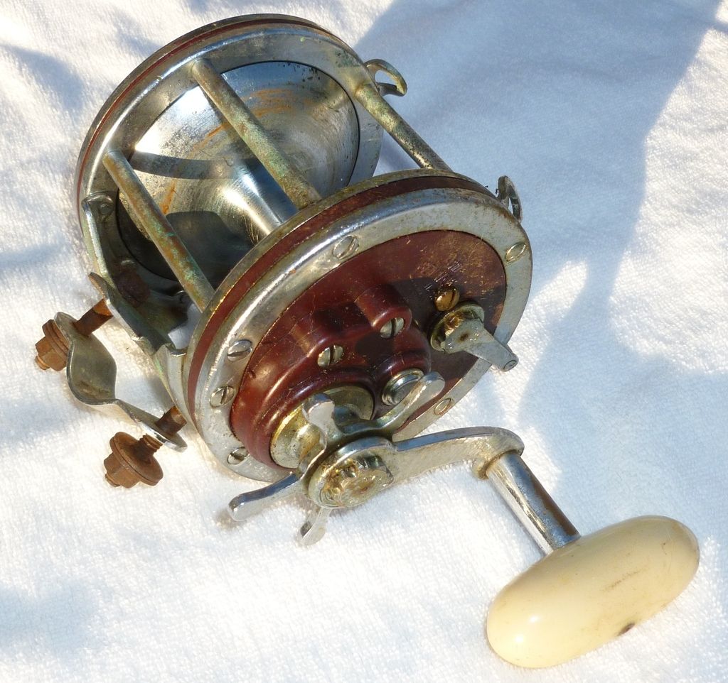

Thor, in due course I'll post pics of the whole procedure, but meantime just to give you an idea:
This poor reel!  :-[
Is there enough Simple Green in the world??   :P
In short... YUCK!!   >:(
But stay tuned...
~A~

Well I guess it's better then to be left dry & rusty. It's easier to clean up oil & grease then rust & corrosion. Time for the rubber gloves & toothbrush.
  Ha ha, no shortage of grease.
  Love those old steel gears  :o
Lawd How Mercy! :o
Aiala, you can do it. Keep the Faith! ;)
When I get one in that bad of shape, I skip right by my normal cleaners.
I put all the parts in a small bucket and pour in Coleman Fuel.
Swish it around a little bit and let it sit for a few minutes.
Then get out the brush and gloves.
Wala! Mess Gone.
Just be careful, as it is highly flammable. Dries quickly and doesn't stink as bad as Brake Cleaner.
Pour it back into the container and seal it up because it evaporates quickly. Just my way.
Quick and Effective.
