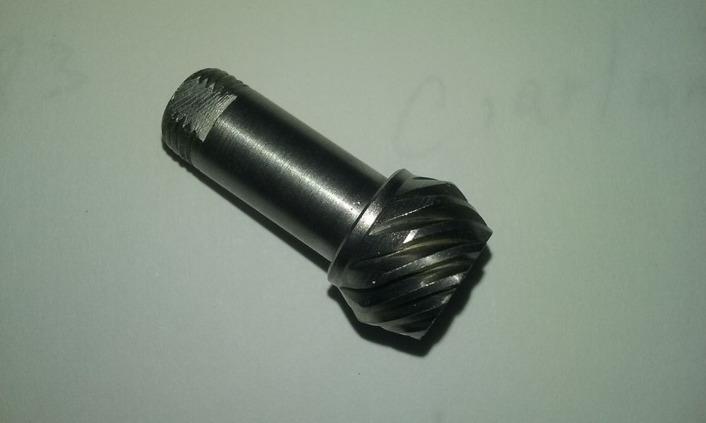

Paul, the earlier 650-750/850SS all came with brass gears as for crosswind, main and pinion.
Later Penn introduced the 6500-7500 and 9500'
They decided to place the cast aluminum gears in those, keeping the pinion brass.
If you purchase one of those today it would be as purchasing a fortune cookie, you will need to remove the side cover and there is a good chance that you'll find the brass gears.
I believe Penn put some of the leftover brass gears in those to use them up, but at the very beginning of when the change took place.
Why would  they downgrade from brass to cast aluminum? I couldn't tell you.
I could speculate that the brass got too expensive to machine, or maybe  that the reel was too good and needed some changes soo they could have more sales...I don't know.
There are some ( as me and you) that really love these reels, but as everything else, there are some that can't stand them...good, more for us ;)
The only issues I've found with these beauties is with the dogs and the inner side of the pinion, I still consider it normal wear and tear.
The stock dogs do fail, but we now have stainless steel dogs and ratchets.
The brass pinion, having the stainless steel shaft constantly going up and down through it, gets worn a bit at times, this  happens on reels that are fished hard.
It isn't terrible, the reel will still function well, just a little extra movement with the spool.
It is not a problem for me, I use this one on my personal reel:
Later Paul.
