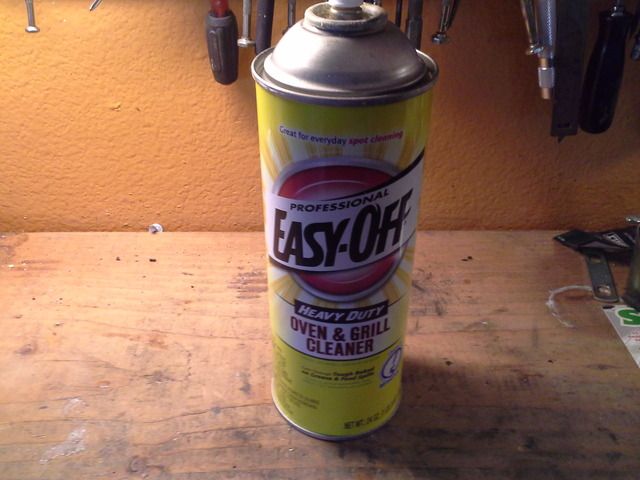

Marcq
Oven cleaner works really well stripping anodizing, it's fast and less dangerous.I've done it many times
Marc..

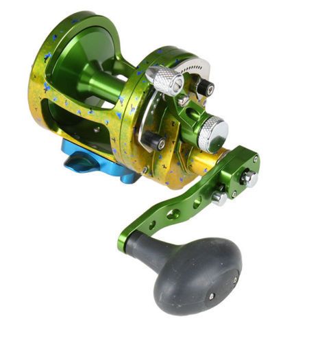

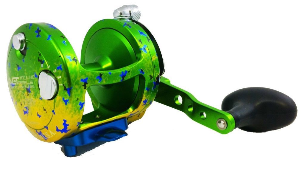

Here's another awesome reel from AVET COMPANY ''DORADO REEL''
Very nice colors
CAMOUFLAGE
