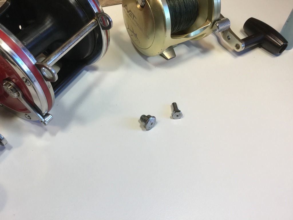

the first thing i'd do is change out the bushings and see if that helps.  you have a 26-60 and a 40-60.  i have a bunch of new 40-60's, but not the 26-60's.  i can send you some old ones to try.  other guys here might have both in new condition, though.
when the spool rubs like this, the bushings are the first thing to check.
Got a couple of new ones, Andy --
26 & 40
If you still need these -- PM your full name and address.
Quote from: alantani on February 18, 2016, 09:50:44 PM
Yup ! and some times that right side bushing is backed off a bit, make sure it's tight. Akfish is also correct with the inner side of the spool, the tolerance on the aluminum is much tighter.
Try the bushing first, if that doesn't do it, you will need to sand down the edge of the bridge a bit.
steelhead_killer
Before I go that route, is this the only way to tell if the bearings are bad or worn out?
