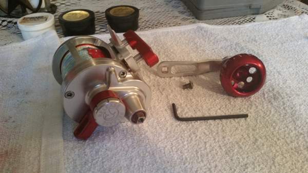

So, here is the Release (Now Truth) SG in all of it's glory.
Let's remove that handle with the size 3 Metric Hex Key.
After that, let's remove the Lever Drag knob and arm by turning the Lever Drag knob counter clockwise.  Remove and set aside.

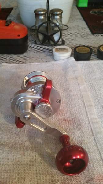

Next, let's grease the lever drag arm, spring and knob.
Reinstall it in the orientation show.
Now, let's take a look at the handle knob.  It can be removed with a small crescent wrench.
Place the wrench on the knob screw, hold it firmly and turn the knob counter clockwise.
And here it is.
Notice, there are 2 thin teflon washers that rest against the handle knob.  The thin one goes directly against the the knob
while the thicker one goes against the handle arm.  There is also a thick teflon washer that rests against the screw head.
Grease this assembly and reinstall it just like you took it apart.
