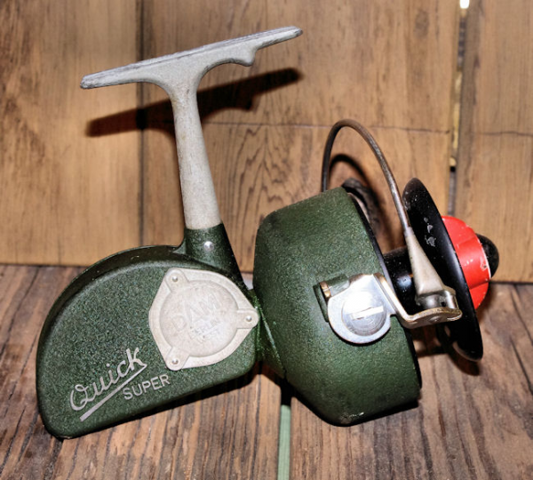

In the old days, DAM Quick had a replaceable foot and stem on their 270 Super Salt Water Series from the 60's.  But these old reels were never called upon to pull the drag numbers we are working with today.  In those days, we would use the rod strength and action to bring the fish to the rail -- and the reel was for primarily retrieving line.
