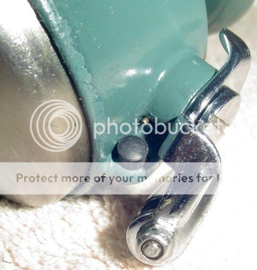

Yes Ray, in the 1930's Penn was feeling out the left hand drive engineering. They built the reel keeping the dog in the same location and simply milling out the plate to allow the dog to engage with the bottom side of the sleeve gear. The dog then was spring loaded upward rather than the normal downward spring loading as seen in this old picture. The plate on the left is right hand drive. The plate on the right is Penn creativity at its best al la 1930's.
I cannot remember if you bought this reel from me; but, if you have it, the configuration of the Left Hand 27 may be the same in this reel. This is a rare reel, it is the first 1949 Penn 180 made in the left hand option.
