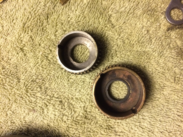

as for the gears,  i have an old Newell, a stock, or Black Pearl's
lets go with Black Pearl's
