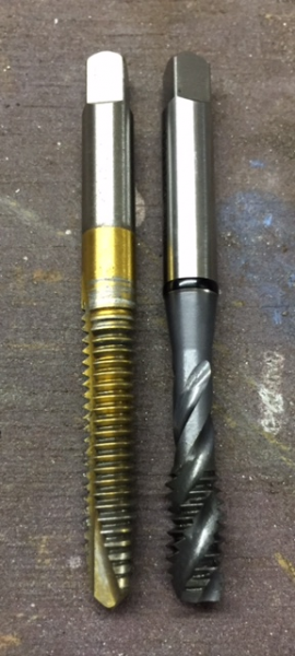

First one: the tap on the left is a Widia 2 flute spiral point plug tap.  The tap on the right is a YG1 3 flute spiral flute semi-bottoming tap. I use the Widia for through holes and starting blind holes, and finish blind holes with the YG1.
The semi-bottoming tap is a special type that's used primarily on CNC machines.  The lead is a little longer than bottoming taps by just enough to make it start well in a CNC machine.  It is not a good choice for starting a tapped hole by hand, but does make a nice tap for finishing a blind hole very close to the bottom.

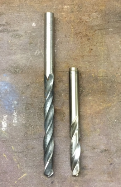

The second picture shows the difference between standard length and screw machine length drill bits.

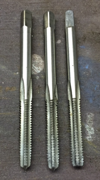

Another picture.  This is a set of straight flute hand taps showing the 3 different leads.  On the left is a taper tap, in the middle is a plug tap, and on the right is a bottoming tap.
McMaster Carr sells 3 tap sets like this in most, if not all, sizes.  They are a good choice and are not terribly expensive. Personally, I prefer the spiral point and spiral flute taps.  Those are considered high performance taps, and it's because they work better.
