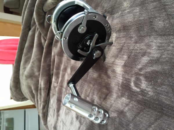

I got the handle in from Adam and mounted on the reel.
I think I want to put JB60 hollow with a short 40# top shot. Any ideas how much this reel holds?
spc7669
The star, not the handle. Head smack #2.
