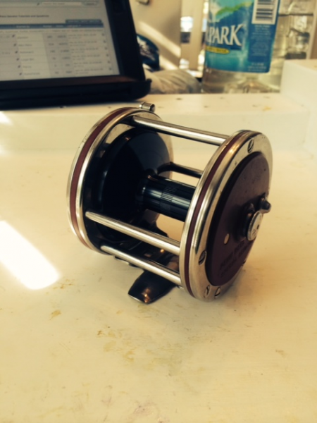

Here's the end of the story, and it's pretty good.....
I passed along all the information here to the customer. He took your advice. Boy did he ever.
He met me close by to give me the 3/0 for a scrub. Had me pull out my iPad, and pull up the Okuma Solterra. He commenced to order two 50W's. If one is looking to move up in size and power from a 3/0, that'll do it.

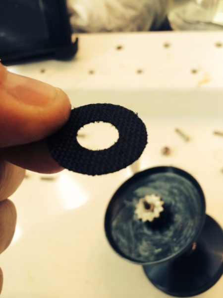

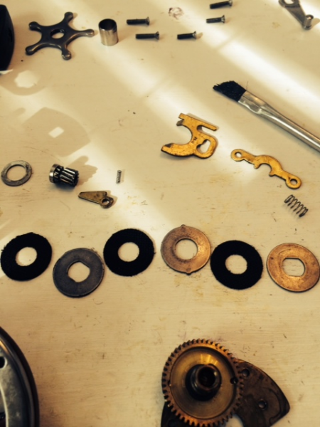

So I took the 3/0 home. Already noticed it had an aluminum spool and was very clean.

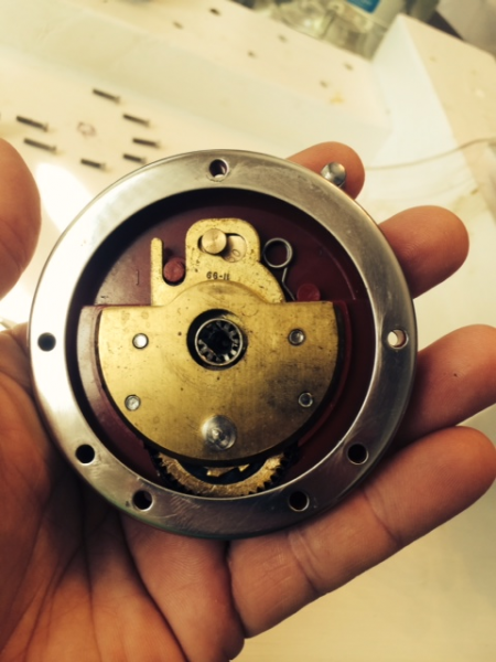

I got into it and it was super clean inside with a pristine 3 stack of carbon fiber washers. I cleaned and greased it and zipped it back up.
spc7669

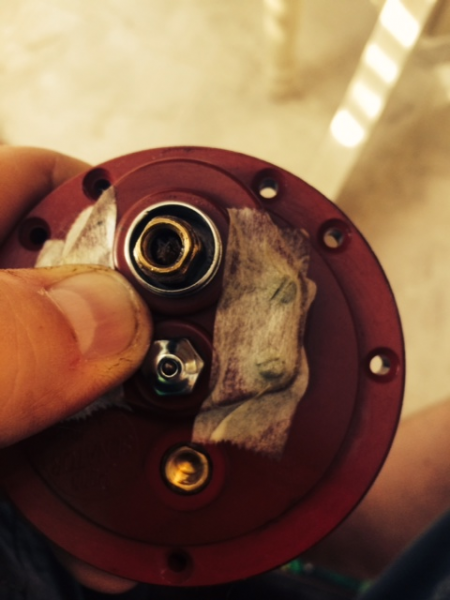

I know the boss says to cover the bridge screws with your fingers, flip it, and install the bridge. I'm too clumsy. Athletic tape works better than my 10 thumbs.
Thank you all again for your help and advice.
