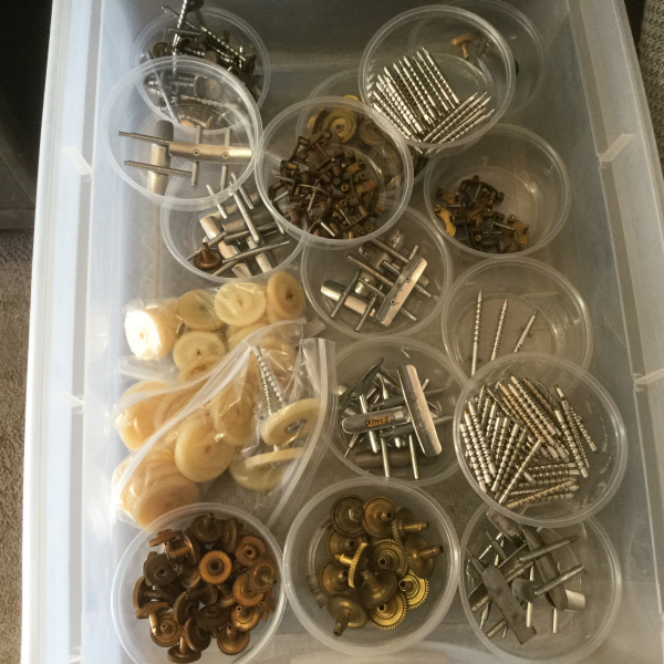

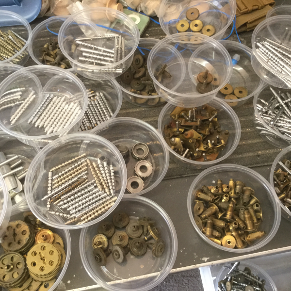

If you ever need any old Shakes parts -- I might have what you need, if we are lucky enough.
Got about 80 pounds of old Shakespeare parts for the vintage baitcasters about 20 years ago from a shop where the owner had passed on many years prior.
There is little market for any of these -- even though they are new old stock from a couple of generations ago, and probably not available anywhere else in the world.
So if you might be able to use something, I can send it out at N/C.

  Thanks Fred. I believe I could sit in your shop all day...just drinking coffee and listening...and learning. If I ever get into trouble finding a part I'll shoot you a message. Also Thanks to everyone for the compliments.
Rancanfish
Visiting Fred's shop would be like the Penn factory visit,  only a bunch more brands to ponder.
