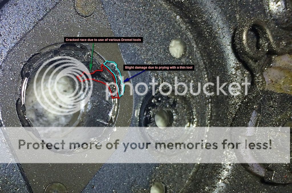

I got sent a Tekota 600 LC which had.. well.. been fairly neglected by the owner. I'll let the picture speak for itself.
Anyway, I got the reel back to how it's suppose to be, but for the first time I came across a failed AR-B bearing in a Tekota. The inner pins fell out, so did the plastic housing. But the frame is stuck like crazy to the sideplate, and being a Tekota, there's nowhere to apply pressure in order to squeeze the frame out of its pressed-in position.

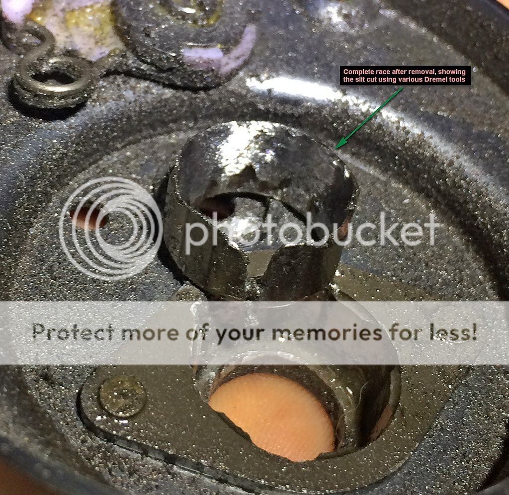

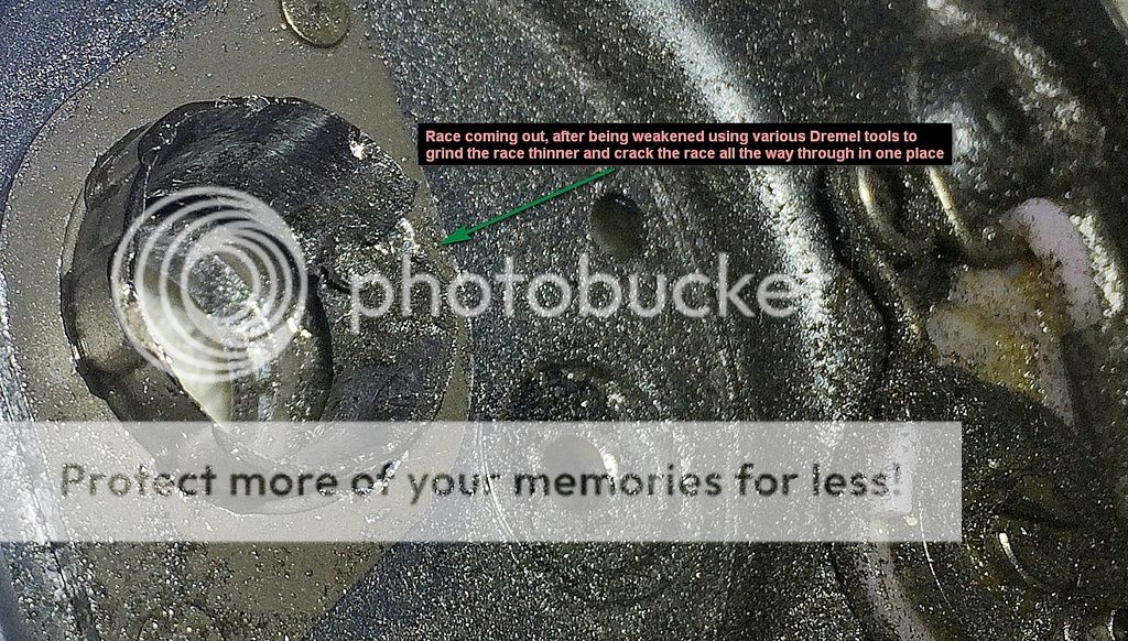

Well, finally the race gave in. :) Man, I've spent many hours with this reel.. wish I had purchased the Dremel tool earlier, this thing really did the trick when I decided how to tackle the problem.
I decided to focus the Dremel on a particular area, wearing down the metal gradually in that place. When the race was almost cut all the way through, I noticed that the metal still would not budge when put under pressure at the cut slit. I therefore took another Dremel tool, and rotated it all the way around the inside of the race, wearing down the entire circle of the metal. Not cutting slits (as the tool don't have cutting discs small enough for this task), but making the metal thinner and thinner all the way around the inside.
Finally, after quite some time of using the tool, I could see the race moving towards me when prying the race at the slit. I slipped the tip of a small fishing hook in at the top of the race, and could pull the whole thing out. Really happy that the idea worked out.
Thank you for the comments and suggestions, I appreciate every comment.

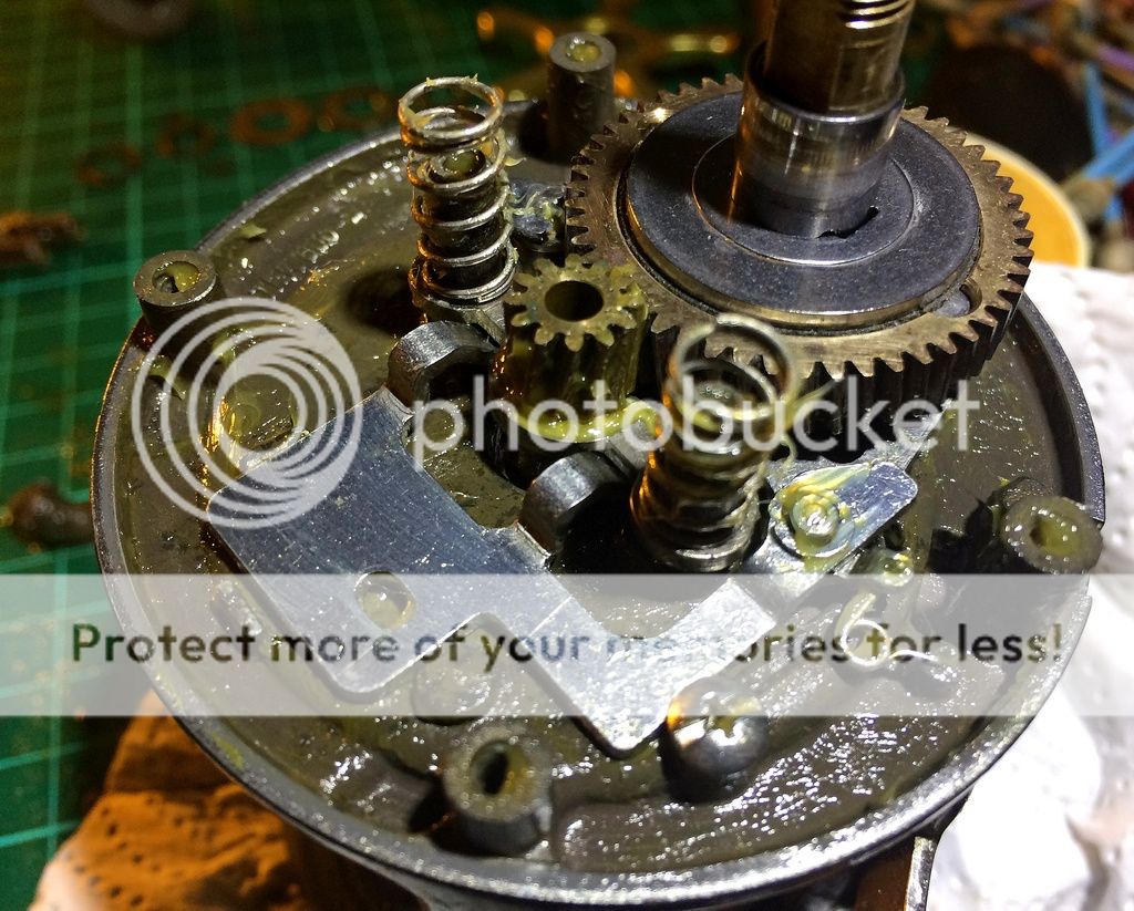

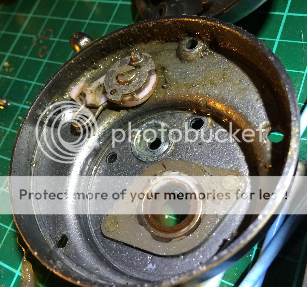

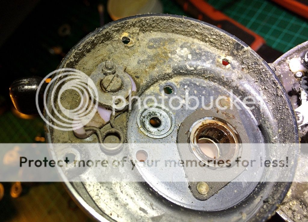

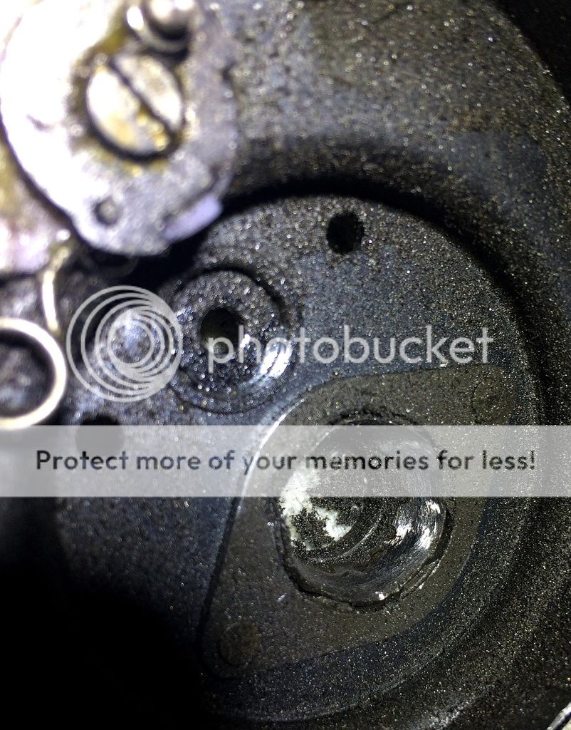

Here are some photos that I took during the process of working on the reel, from the moment I opened it the first time, and to the finished service earlier today.
Just after opening the reel
Not a nice sight
After some quick cleaning. Note how rusted the AR-B is in this picture.
After use of Dremel tools. Some slight damage to the inside of the sideplate due to attempts at prying the race using a thin screwdriver. This slight damage does not affect the housing of the AR-B at all, luckily.
Here after quite a lot of Dremel use. Notice how the metal in the race has worn down and become much thinner.
The race coming out, after being worn thin using Dremel tools. Note that the race has been worn quite thin and thereby losing a lot of the pressure that it originally had when installed in the sideplate.
The race fully removed from the sideplate
The new AR-B installed
The inside of the reel after been cleaned and greased - ready for use once again
