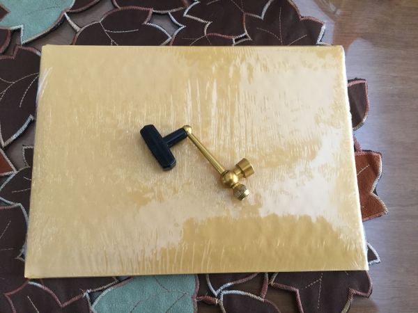

Thank You Fred.

Daron, there were two bail designs but I do not remember which one came first.  My recollection is that the handles were always gold color but I could be wrong about that.  This one was bought new back in the day.

New bail spring, Handle courtesy of Fred, every single piece of this reel redone.
