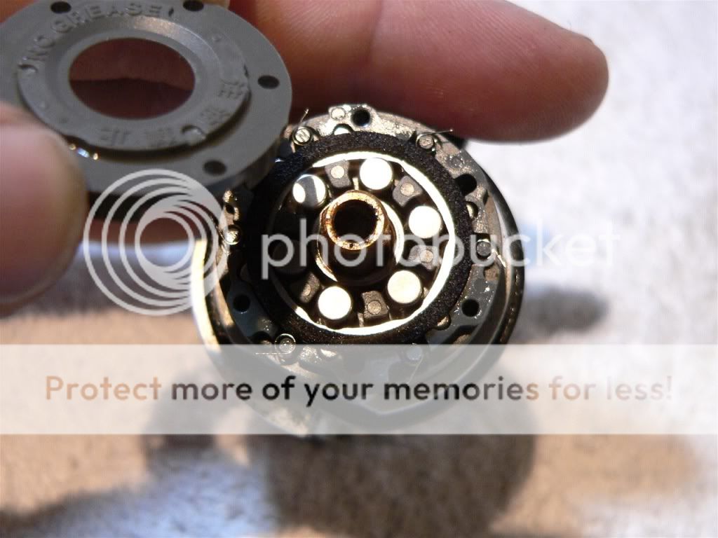

Not sure if it helps but here's a pic of an AR bearing in a Stradic 2500 FH. You can see the general position of the springs and pins.
Did you grease or oil the bearing? They're very sensitive to being over-lubricated and will often slip if given more than a 'fingerprint coating'.
Cheers, T
