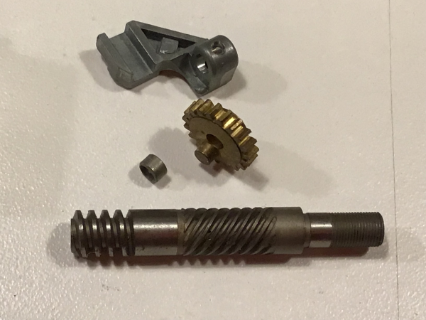

I cleaned and lubed it a couple weeks ago, so it was either never there to begin with or was lost in the clean up. It's a learning process to know what to look for. Now I know for the next time. These are fun and not to bad to work on, I love it! Will be on the look out for more. Have one 265 and two 110's now.

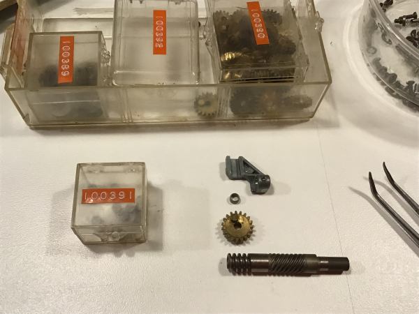

Here is what the tiny steel roller looks like —
Think of the German engineering and thought that went into just this tiny aspect of the spool oscillation function...
We have a machined spiral worm pattern on the bottom end of the steel worm pinion gear — which in turn drives a brass worm gear — that then operates the spool oscillation slide.
The engineers could have just left it at that — 99% of the manufacturers do — and it works just fine.
Instead, the engineers took it a step further by using this steel roller to reduce friction and wear even more.
The more you really study these D.A.M. Quick reels — the more you will understand and appreciate the craft, skill, and engineering that was not just added on when needed — it was built in from the start.
These reels, with their tight tolerances where needed — and loose flexibility when useful — will still work perfectly 100 years from now — if just basically serviced and maintained.
If these Microlites were manufactured today — they would likely be a top seller, and retail for between $200 to $300, IMO.
Just simple, overbuilt, and functional.

Quote from: foakes on January 13, 2019, 03:35:47 AM
Check around in the grease, or inside the casing — loose.
If you cannot find it — I will send you one at N/C.
I thought I found the roller Fred, but it was to different reel I had parted out. I sure do appreciate your generosity!
Thanks
Jeff
Dropped it in the mail this morning at the Post Office.

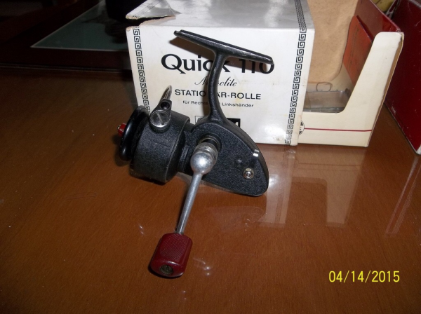

Yes, Jeff is exactly right...
265 Microlite is the smallest.
110 is next smallest.
110N is the largest of the Microlites.

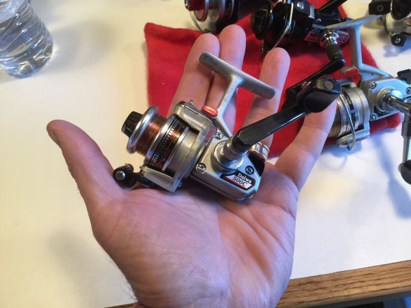

Here is a photo also of a true Microlite — a Daiwa 500C — also one of my personal favorites.
I have a personal arsenal of about 100 small spinning reels — many are Microlite size.

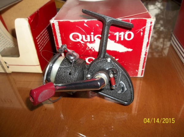

To prove this, I have a boxed 265 Microlite, with full paperwork and accessories.  The box reads Microlite, the model # reads 110 on the box — but pictured is a 265 Microlite.  The owners manual reads "110" formerly the 265 Microlite.  And the manual is very complete and humorous — and is put out and distributed by Gladding Corporation!  All illustrations are of a 265.

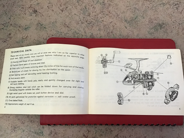

This is a really unique owners manual —
Distributed by South Bend Tackle Company, a Division of Gladding Corporation in New York.
