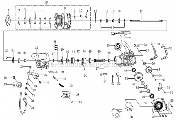

New to the forum and found this place trying to research on my reel when I took it apart and now cant assemble . I took pinion gear and bearings and clutch out, was just going to lube and clean there was a slight hangup when reeling . So took all that off together and when I replaced it the bearing sleeve will not set flush inside the body and cannot screw the plate back on flush.
I know i've done something wrong but just cant get it. I have taken the parts out over and over and just dont see what I'm doing wrong. It only sticks up a fraction of an inch but should not. I have another brand new reel like it but afraid to take it apart or same thing might happen LOL. really am hoping an expert here can give me advice. PLEASE HELP

Should just slide back in and the bearing should be flush to allow the bearing retainer cover to be screwed in place.
Sounds like you might take off the side-plate -- and as you reinsert the parts, pinion, bearing, clutch, etc. in place -- slightly lift up on the main gear so the pinion seats in a mesh position with the main -- or turn the handle slightly as you reinsert, so the bearing seats along with the pinion.
Sideplate needs to come off anyway, so you can reattach the spool shaft to the crosswind block, I believe?
Sometimes, just jiggling as everything goes back in place will help to seat properly.
Pics always help to diagnose an issue a little quicker.

Got lucky -- just the nylon bearing spacer that surrounds the outer pinion bearing was on the wrong side of the bearing.  The schematic is not real clear in this regard -- likely because there are two bearings close together.

Here is a picture of the pinion gear and its bearings assembly for that reel. In the Penn reels the round "cup" for the top bearing is aluminum.
Keith
