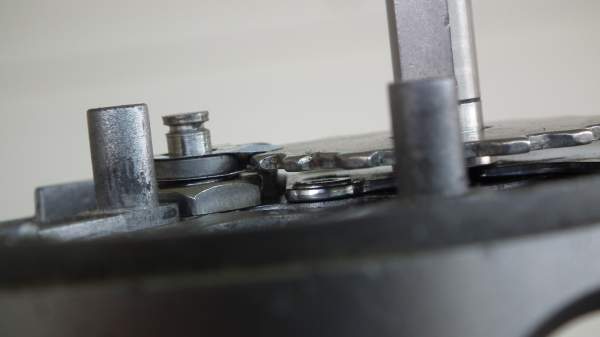

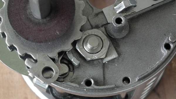

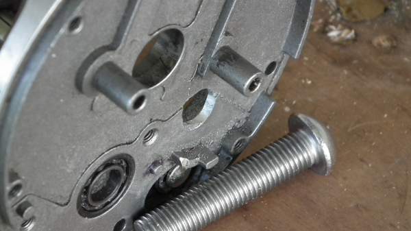

There have been a couple of failures of the Saltist A/R dog post reported over the years. Alan T showed one that had sheared off of the frame a few years ago, http://alantani.com/index.php?topic=227.0 and I have had this one from around the same time, that didn't shear off but pulled a piece of the frame out with it. It was 2nd hand so I don't know what caused it to fail.

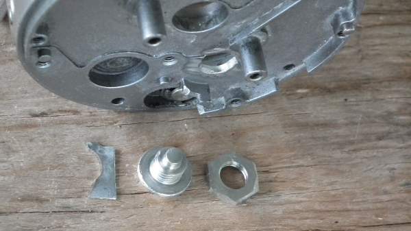

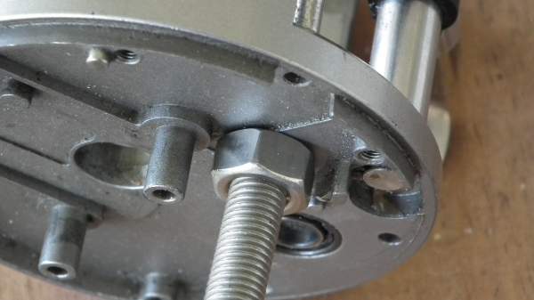

I thought the best way to repair it would be to spread the load by clamping the area surrounding the hole between a flat nut and bolt with as much area that would fit. I came up with a stainless 5/16" cup head bolt.
The hole in the frame needed to be cleaned up with a needle file to fit the bolt.

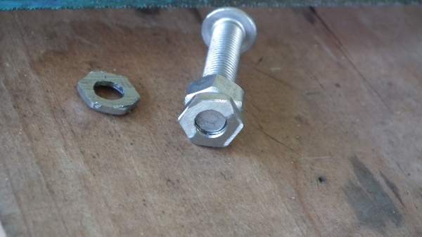

Both the bolt head and nut were too high and needed to be modified for clearance. The bolt head was gound down on a bench grinder then sanded. The nut needed to be 2.5 mm thick to match the height of the dog support on the original post. I hacksawed the nut in half and ground / belt sanded it to thickness.

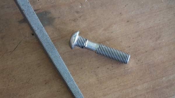

There is a 0.5 mm step in the thickness of the frame that runs across where the post is. I shaped a 0.5mm SS shim to fill in the gap under the nut so the load is spread around the circumference. ( I missed a few photos along the way) The next step was to file the bolt to fit the hole in the dog. I started by filing the threads off to make it easier to start in the drill press.
The shoulder the dog will rest on needed to be 4.5 mm from the head to match the original post. The filed bolt with flattened head, the 2.5 mm nut and the 0.5 mm shim,

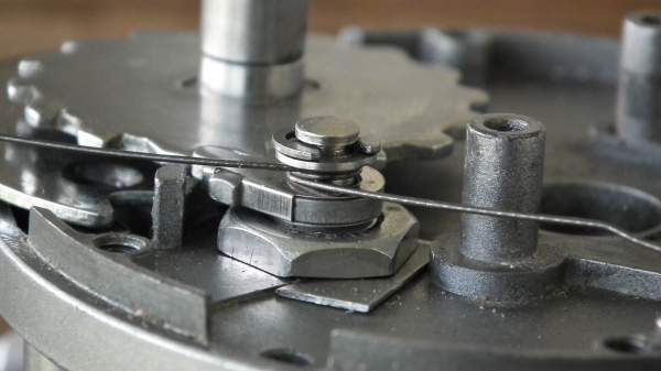

A dry fit and all looks good
This is where I thought I would be clever and put a spring on top of the dog, held in place by a washer under a C clip;
Then I came unstuck - I was checking the clearance below and around but not above - the main gear sits over the dog post. I'm glad I didn't finish shaping the spring  ;D

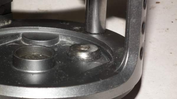

OK, back to plan A - replace the post,

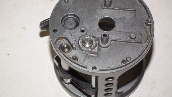

I cleaned the paint from the frame around the hole, with a dremel wire brush and cleaned all parts with carb and brake cleaner before final assembly with loctite 660
I'll let it sit for a day or so before testing the dog without the A/R roller clutch.

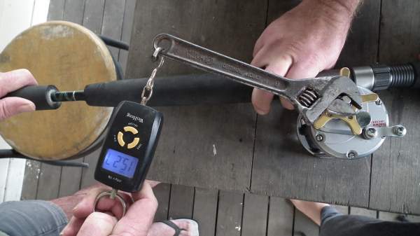

I tested the dog post today using Jurelometer's thread to calculate the load. http://alantani.com/index.php?topic=14241.0
Working with 1.8" dia spool, 6.4:1 gear ratio and 30 lbs drag I got 173 lb/in torque. Using a crescent wrench with 7" from the shaft to the hole in the wrench handle I needed around 24 lbs force on the wrench.
The A/R bearing was taken out so the dog took all the load.
At 15 lbs;
After reaching 24.5 lbs the dog, post and ratchet were checked and it was all good;
Looks like the post works - I'll try putting a spring on the dog at some stage.
